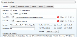

One of the main problem I was having is that for some reason, some emulator would not launch via HS despite having the exact same setup as others.
NGB roms would not load while NGBA roms would run fine.
Both setup to use RetroArch, both setup have the same 'wheel option configured' in HSHQ
... yeah ... this was messing with my head badly ...
But after a last attempt on Sunday morning 1.30 AM ... I got it working ....
I did so much tweaking & tinkering that it's hard to pinpoint the exact reason for the fix but I believe the below 3 steps where essential:
1. RocketLauncher pushed a new update
2. Step 5 in Ghutch92 How To
3. Included Rom path & Extension in HSHQ as per attached file below (and this allow for "Show Rom only" to work too!!!!)
and Voila ...  I applied those settings to the rest of the available wheels and the sweet sweet feeling of victory spreaded through my brain ....
Again, I'm not 100%  sure what exactly did it, but now it's working fine so I can move on and concentrate on what's next ...
