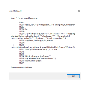

YuSmites Posted December 29, 2015 Posted December 29, 2015 Hey guys, I've just started up with HyperSpin a day ago and it's rekindled my interests in emulation. I was watching the video series created by Simply Austin and I got HyperSpin 1.4 to run as well as RocketLauncher. i installed Dolphin v. 4.0.2 (the most recent STABLE version) and it works perfectly by itself (I can also run it through HyperLaunch if that means anything). However it wont run through HyperSpin or RocketLauncherUI. P.S. - Before anyone asks I've tried using the version of Dolphin that the module was created for, still no luck. P.S.S. - When I start up RocketLauncherUI it seems as though RocketLauncher doesn't start along with it and when I try to start a game this error pops up (see attacked image). After that RocketLauncher starts on its own and I don't get an error message but the launch buttons in RocketLauncherUI for running games are unresponsive.
YuSmites Posted December 30, 2015 Author Posted December 30, 2015 I've just posted on the RL site, hopefully they can tell me what's going on. I didn't know HyperLaunch was obsolete, it was included in the files I downloaded from this site (HS 1.33). The confusing thing to me is that I followed the tutorials exactly; I even started fresh with new install several times on several drives both on and off my computer..same result every time.
YuSmites Posted December 30, 2015 Author Posted December 30, 2015 This issue has been solved . It was an issue with my computer being set to a different localization; apparently a lot of people have had this issues over at the RL site.
