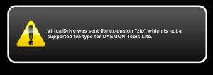

Daemon error "virtualdrive was sent the extension "zip" which is not supported file type for DAEMON Tools lite"

Guy`s,
I had this error a week a go with Saturn (SFF) and managed to sort the issue as suggested by agent47 & spawk by making sure 7z was enabled in RLUI and in SFF module (Global) settings CDRom drive was set too 0, 1 or 2. My mates got the same issue and ive tried all the fixes that corrected mine
But im still getting the error?
Does anyone have any other ideas \ fixes that I could try.

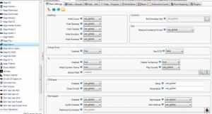

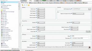

Agent47, AVAR I've attached the log and added screen shots of my global and local system settings. it would be nice if anyone could provide a screen shot of their settings for SFF so I can compare.
Cheers guys.
