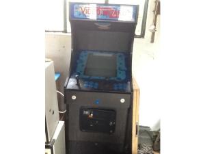

Also ,this is a picture of the cab but i really don't like the flat down screen orientation and much prefer the screen upright but i don't
think this jamma arcade is like the old one i used to have that you could lift out and rotate vert/horz ,do you think it would be easy to
mod this display to an upright one ?
What do you call this type of cabinet where the display is inset in the flat orientation ?

On further inspection of the laptop i can see that i was wrong in saying it had a vga port,it's a dvi port,also i have been hunting through google for into on arcade screen to svideo or to dvi but
i just can't find much of anything on the subject,i have also learned that the cab i am interested in has a game board inside (an army game) that sounds like ikari warriors but the lady doesn't know
anything else about it apart from that everything works including the coin mech and she still has the keys for it,but i also found out that the screen and glass overlay is 27in square and can be
rotated vert/horz so this is good as i thought it looked like a vert shooter only orientation.
