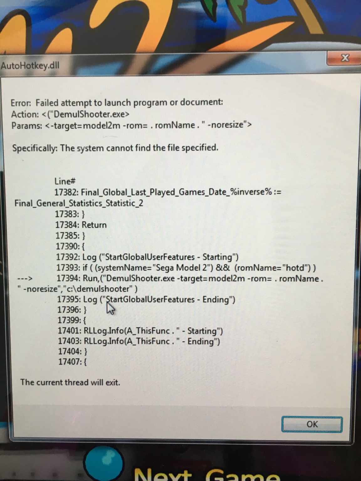

TITCHGAMER Posted June 26, 2016 Author Posted June 26, 2016 Hoping you may be able to help me out again 47! Or anyone else who can.... I found the thread you refered to above and have tried to modify the code to work but not had any joy. This is what I have:StartGlobalUserFeatures(){Global systemName, romName, emuPathLog("StartGlobalUserFeatures - Starting")if ( (systemName="Sega_Model_2") and (romName="hotd") )Run("c:\demulshooter\DemulShooter.exe -target=model2m -rom=" . romName . " -noresize", emuPath)Log("StartGlobalUserFeatures - Ending")}I then start the game through hyperspin but my crosshairs are stuck in the corners as they would be if demulshooter did not start correctly.I have also tried creating a BAT file for HOTD which has the same effect but I know my BAT is good as if I manually run it and the emulator it works fine.Again any help appreciated.
TITCHGAMER Posted June 26, 2016 Author Posted June 26, 2016 Thanks 47, I have tried that with the same results. I tried taking the underscores out of Sega_Model_2 but it errors out then when launching the game.

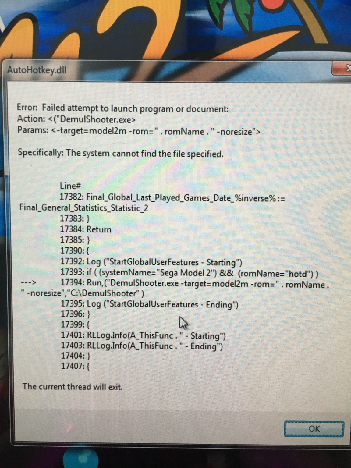

TITCHGAMER Posted June 26, 2016 Author Posted June 26, 2016 Strange, yes i did try it but it didnt seem to do anything :s
TITCHGAMER Posted June 26, 2016 Author Posted June 26, 2016 Also I dont have _ in RL or HS as far as I know but if I dont put them in there the script errors out when launching the game.
TITCHGAMER Posted June 26, 2016 Author Posted June 26, 2016 OK update it now works Dont know why but ime not going to complain!! LOL So just a quick q, To get it to work with other roms I would just stick a or statement in the roms part right? ie: romName="hotd" or romName="vcop" or romName="vcop2" etc etc.
TITCHGAMER Posted June 26, 2016 Author Posted June 26, 2016 Ok all fixed and working Thanks agent 47 as usual you are a legend! So for anyone who needs a working code for this in future this is 100% working with all games for Nebulas M2 emu: StartGlobalUserFeatures(){ Global systemName, romName Log("StartGlobalUserFeatures - Starting") if ( (systemName="Sega Model 2") and (romName="hotd" or romName="vcop" or romName="vcopa" or romName="bel" or romName="gunblade" or romName="rchase2" or romName="vcop2" ) ) Run("DemulShooter.exe -target=model2m -rom=" . romName . " -noresize", "C:\demulshooter") Log("StartGlobalUserFeatures - Ending")}
