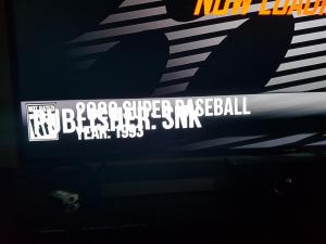

I have set up my first system in Hyperspin the snes :) with help from Simply Austin and it seems to be working perfectly. But as you can see in my attached foto some information are top of each other? Not sure how to fix this.
  On 8/9/2016 at 7:43 PM, agent47 said:
It looks like you need to adjust the font size and position of the Publisher info. You can do this in RocketLauncherUI on the Settings -> Fade Info tab. Check the "Game Info Order" text box to see what position number the Publisher info is and adjust the corresponding "Text # Options" box below that.
Thanks that helped. it was on some custom setting for some reason so i just picked the default option or what its called.
