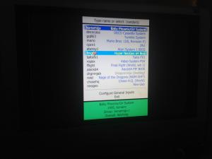

Anybody had an issue whereby some games work via rocket launcher but they fail or give you the game select wheel in hyperspin, ive checked all the databases and the games appear green could this be the mame version/rom numbers etc? ive checked bios' made sure i have them all

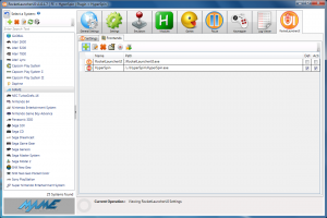

copy of settings.ini from hyperspin below screenshot of what happens when i run after burner 2 from mame also RL showing HS as default front end and active
using mamegfxui 0.167 and all bois' in roms folder
