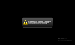

BostonD Posted November 27, 2016 Author Posted November 27, 2016 Now Im getting this and I checked the rocketlauncher path and I have the Sammy Atomiswave.xml in the database path and it looks to me like its spelled correctly
