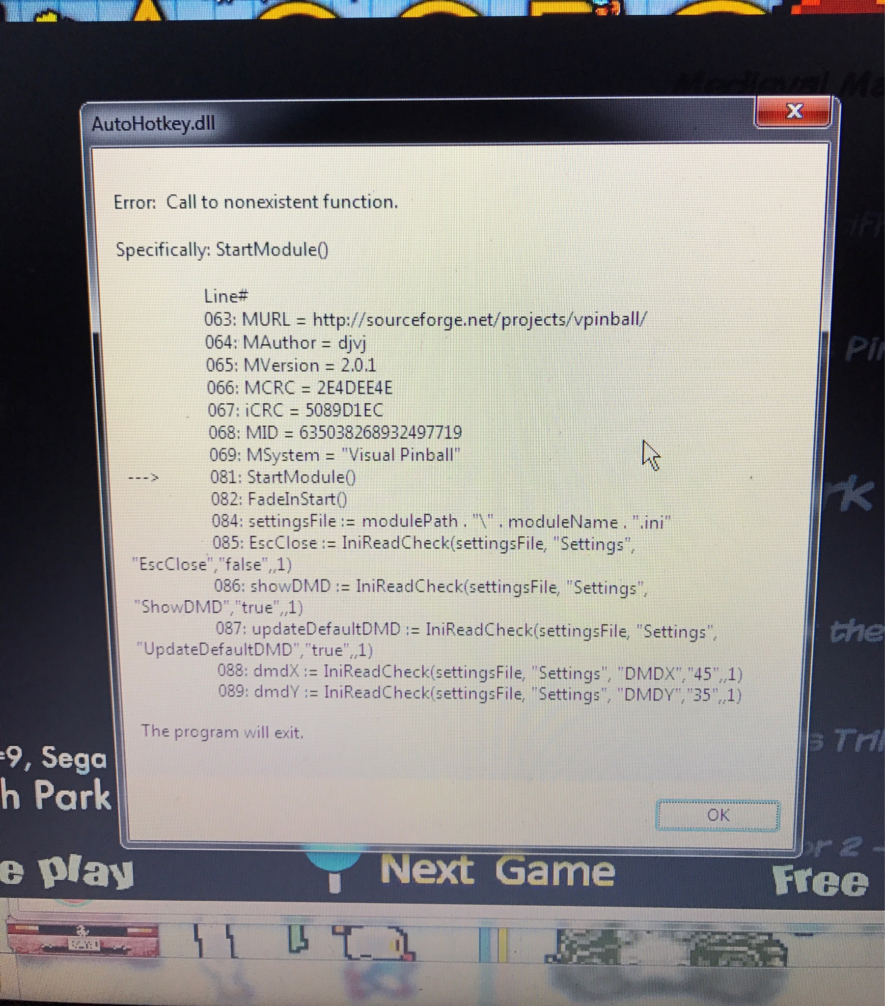

JDarcade Posted February 13, 2017 Posted February 13, 2017 Trying out another way to play pinball with my setup and running in to a few problems. In UI it plays and loads fine. When I try in hyperspin I frost had the error of missing .ahk file. So I copied the one from rocketlauncher and now get another error. Did I need a different.ahk?
JDarcade Posted February 13, 2017 Author Posted February 13, 2017 I can't see that pic but it sounds like you're using HyperLaunch. If that's the case you can't just copy RL modules, they will not work with HyperLaunch.Oh okay that must be my issue. Can that file be downloaded or would that have to be a custom made?Sent from my iPhone using Tapatalk
JDarcade Posted February 13, 2017 Author Posted February 13, 2017 Nothing has been developed for HyperLaunch in a very long time so if you want to stick with HyperLaunch you would have to write the module yourself. The other option being ditch HyperLaunch and switch to RocketLauncher.Oh wow okay thanks hmm have to think about what to do next. Sent from my iPhone using Tapatalk
JDarcade Posted February 15, 2017 Author Posted February 15, 2017 So apparently my test computer has an older version or something wrong with it. I just for fun tried it on my hard drive I'm building for my cabinet and it loaded no problem. Sent from my iPhone using Tapatalk
