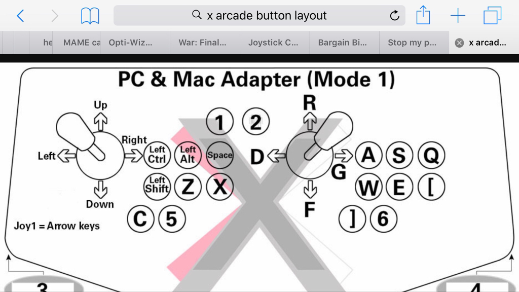

I'm using Xarcade setup ( so close to rewiring going with I-PAC 2 ). But when people play games like street fighter or other fighting games and get into button mashing MAME will close or min minimize. So on screen it's back on Hyperspin and you can hear the game still playing over the speakers. Is it some hotkey issue or something?
The setup at the moment
You're probably triggering the RocketLauncher Exit Script hotkey which is set to Q and S pressed together. You can remap that hotkey in RocketLauncherUI on the General Settings -> Controls tab.
Oh awesome thanks. That must be it if I remember correctly it happens only with player two buttons.
