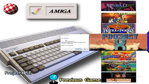

skandalo Posted June 8, 2020 Posted June 8, 2020 Hi.. for a few days hyperspin from this problem, I don't understand what may have happened ... continuing the running of the script the games load normally, every time I change the game the error reappears and this for every type of emulator. i tried to erase everything and reinstall both hyperspin and rocketlancher but the problem reoccurs. do you have any solution? thank you all

skandalo Posted June 9, 2020 Author Posted June 9, 2020 Thanks for the reply i have 3 amiga-mame-model3 emulators everything works regularly, but every time I change the game it gives me a script error, if I continue running the script the game starts regularly I tried to install NET Framework 4.0 but it tells me that it is present the games start from hyperspin

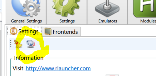

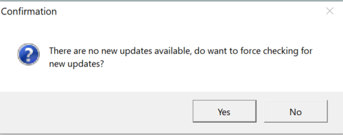

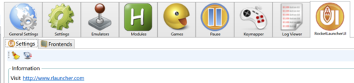

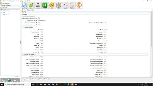

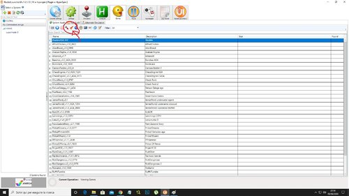

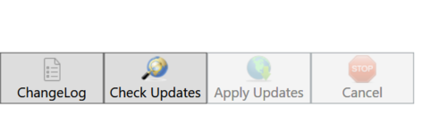

pacifikballa Posted June 9, 2020 Posted June 9, 2020 27 minutes ago, skandalo said: until a few days ago everything worked. maybe updating windows? i also tried to delete rocketlauncher and hyperspin and use the latest version sorry but I'm using the google translator No worries, I can understand you. What version of Windows are you on? I would suggest trying to manually check for updates via RL first, since this seems to be an issue with RL and Windows (process of elimination): Open RL, go to the RocketLauncher UI tab on top: Click the globe: Click Yes: Click on Check Updates on the bottom: Click on Apply Updates if there are any that pop up. Maybe that will pull in and correct some corrupt files somewhere causing you issues. Check it out and let me know.
skandalo Posted June 9, 2020 Author Posted June 9, 2020 I updated and replaced some files .. nothing has changed 2 days ago I tried adding PC Games with could pclauncher be the problem?

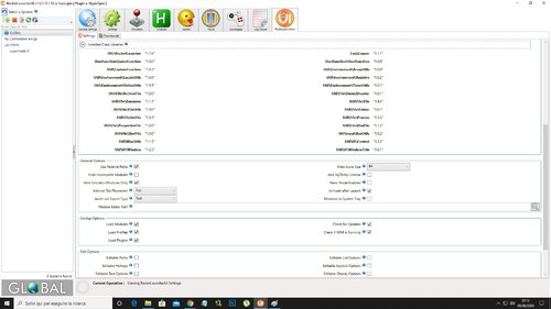

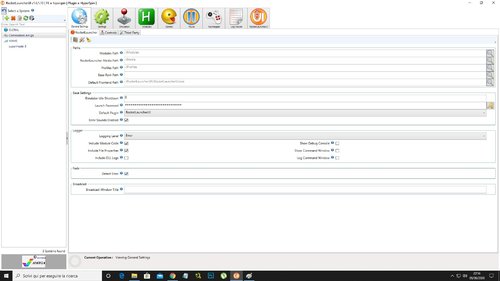

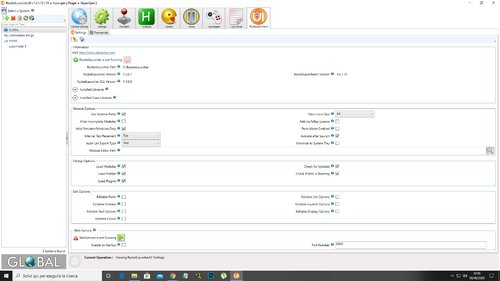

skandalo Posted June 9, 2020 Author Posted June 9, 2020 I tried the cmd command unfortunately it didn't work I send you the images that the mail did not give me error

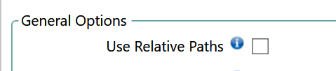

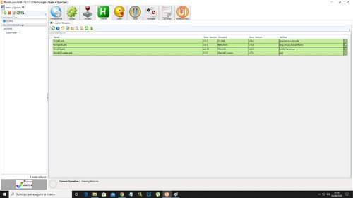

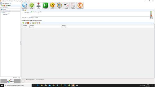

pacifikballa Posted June 9, 2020 Posted June 9, 2020 Uncheck Relative Paths...that should be left empty.... Take a few more screenshots for me too. Settings/Main Settings, Emulators, and Modules. Just trying to check the simple things first. Thanks.

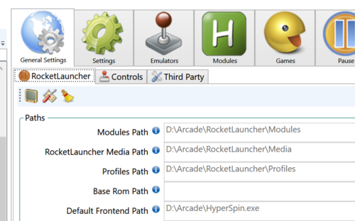

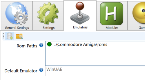

pacifikballa Posted June 9, 2020 Posted June 9, 2020 12 minutes ago, skandalo said: ho visto avviando il gioco come un lanciarazzi non per errore di script (screenshot😎"> So do you still have script errors? Yes or No....I think you said no more script error correct? Also, there are a few things you need to change in your setup. Copy these settings: Your Default Frontend Path should point to the HyperSpin.exe file NOT RocketLauncherUI.exe Your Default Emulator should be WinUAE NOT WinUAE Loader And also make sure HyperSpin is your Default Front End and BOTH boxes are checked Default and Active Then try to launch HS and try to to load an Amiga game. Let me know.
skandalo Posted June 9, 2020 Author Posted June 9, 2020 yes i still have script error, but starting it from rocketlauncher not from error (last image)
skandalo Posted June 9, 2020 Author Posted June 9, 2020 I changed my settings with yours continue script error
