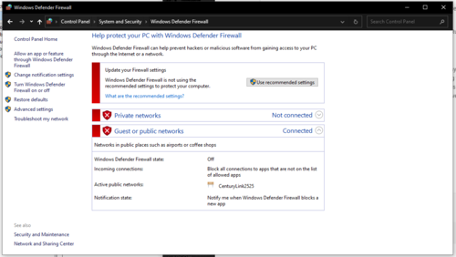

I had turned off Windows Defender *in the control panel*, and added an exception for HyperSpin.exe anyway even though that shouldn't matter with Defender turned off.

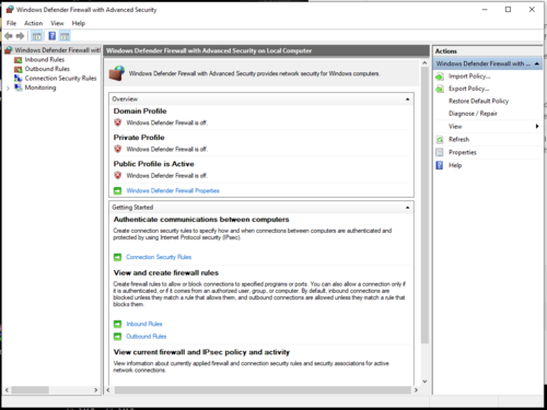

So I still had the issue with all of that done and I decided to double check myself.  I used the Windows search blank next to the start button to open Windows Defender settings again expecting to be take to the Control Panel again, but instead it offered a different window.  This time it launched the Windows Defender Firewall with Advanced Security window.  It said Defender was turned on, so I turned it off here as well.  After that, it FINALLY WORKED!  I just double clicked HyperSpin.exe and the program launched in full screen.
