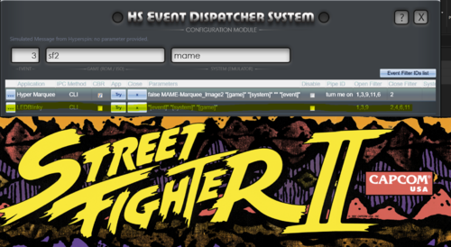

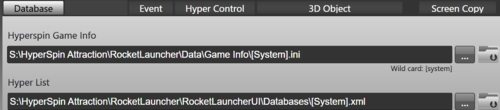

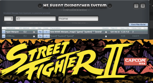

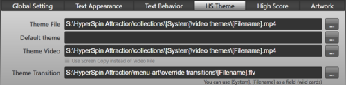

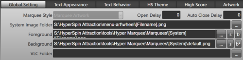

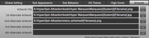

pacifikballa Posted August 29, 2021 Author Posted August 29, 2021 Here are screenshots of my configuration in both HM and EDS. The EDS can call to HM and display the marquee when pressing the blue "try" button. The issue I am having is where to point LEDBlinky (EDS) to or if I even have the correct Parameters or Open/Close Filters. I did modify the RL settings.ini and enabled LEDBlinky and provided the full path, but that doesn't seem to work. So in a nutshell, EDS can call HM and display the marquee, but when launching Hyperspin Attraction, HM fails to launch with the config I have. Any insight? Thanks.
