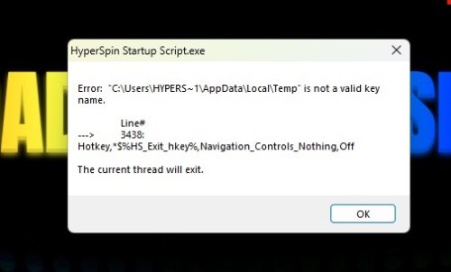

johnramus Posted April 8, 2024 Posted April 8, 2024 Hi guys. I need some help please. I just finished building my arcade cabinet, and everything is working fine. Problem I have is this message comes up every time I launch HyperSpin. Hyperspin continues to work but not sure what's causing it. There is no other error messages. Just what is shown. Any help would be great thanks.
steelpower Posted April 9, 2024 Posted April 9, 2024 Creo que es algo de la tecla de salir, que dice que no es valida!! Tienes la tecla s para salir? Creo que en hyperspin es la tecla de esc si has cambiado asegurate de cambiarlo tanto en hyperhq como en rocketlauncher. 1
