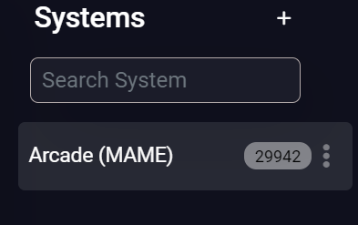

I have the same issue. I have loaded my mame roms with the version of Mame that I used in Hyperspin 1 with rocketlauncher and it has found 9074 but all up I have over 30,500 roms. I did not check to merge duplicate roms so I am not sure why I am missing so many? Some roms are in folders but over 95% are as a zip file.
Would love to hear if anyone else is having this same issue.
I have already deleted and added them multiple times trying different settings but same result.
  • 0
So I think I have solved my issue.
I went into settings and enabled auto import. once the first cycle of imports completed. I closed down HQ. I went into Task Manager and killed off any HQ processes and then started HQ again. Waiting and then auto import starter. I now have 29900 + roms added to HQ Mame.
