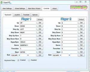

justice999 Posted January 23, 2015 Posted January 23, 2015 Hello, I have a little mapping issue. Everytime I press Esc, HyperSpin leaves the game, goes back to the game list and then go to the previous game (without getting into the game). So basically when I leave a game, Esc = Esc + Up. It does not occur when I'm browsing systems on HS. Such glitch only happens when I use RetroArch, never with other emulator. I use default mapping. Attached my HS control settings. Thanks in advance.
justice999 Posted January 23, 2015 Author Posted January 23, 2015 Restore Frontend on exit: Restore and click seems to fix my problem.
