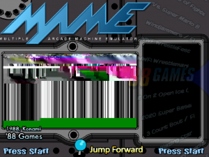

CajunGamer Posted April 15, 2015 Posted April 15, 2015 Preview video is distorted when trying to play. The video files are .mp4 They work perfect when I watch them in other media players. I could find only one other thread from 2 years ago, and none of the solutions worked. Help?

CajunGamer Posted April 15, 2015 Author Posted April 15, 2015 On 4/15/2015 at 7:35 PM, Circo said: I'm on my phone and I don't have it on me but I'm assuming you're using intel built-in video and there's a workaround with some settings in Firefox that turns off flash Hardware acceleration Yes im using Intel graphics windows 8. I right clicked on a flash video in chrome, went to settings and unchecked hardware acceleration. Let me know if I need to do anything else when you get to a computer! Thanks!

CajunGamer Posted April 19, 2015 Author Posted April 19, 2015 On 4/18/2015 at 5:39 PM, Mystul said: Hey CajunGamer, I got mine to work by downloading FireFox. Then installing flash for FireFox and doing the suggestions from above - disable Hardware Acceleration. Didn't get it to work in I.E. or Chrome. Give that a shot. Mystul Mystul, this worked! Thank you! I did this method in Chrome and IE but oddly enough once I downloaded and instaled FireFox and right clicked and unchecked acceleration from FireFox, it fixed the problem. Awesome!
