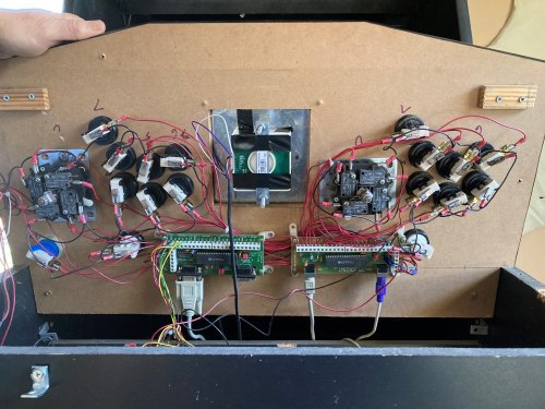

  3. Good morning Andyman, I certainly is a grounding trouble. After I took that picture, I tightened a couple of loose buttons and followed some grounding wires back from button to button. Then I lowered it back down, powered on the game to check the coin drop button. To be honest I wasn't 100% sure that wasn't working as I had been using the keyboard to start it up when I first started looking into it. The coin button worked, and all other buttons worked as well as the joystick. I played a variety of games yesterday evening without any trouble. Thanks for all you help... Happy New Year. I have a question about sound on 1 game. Are you interested or should I open a new post?
  4. Andyman, I am thinking you are on to it with the ground. I have attached a picture of my control board. The Ipac control on the bottom right (PC white - KBD purple) but when I was in the mame keyboard control, I could update the joystick to keyboard conversion using the down or left but not up or right. That makes me think it is ground related. Also looking at the right side, blue button is pause (that does work) and looking at the joystick one half (up and right) doesn't work. That too makes me think it is a ground trouble. It is pretty damn cold here today. (9 degrees, -13 with the wind) I don't know how much outside activity I will do today so I'lll try and fool around now that I have it disconnected... I'll let you know what I find. Thanks

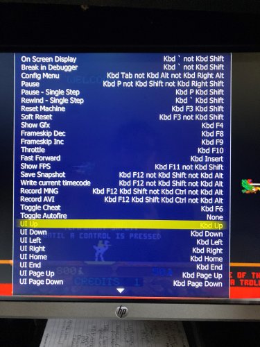

  6. There is one other thing that I just noticed. My problem is that my joystick works down and left. I was testing or changing my UI UP. I just tried my UI down and used the joystick down while in that field. It did update to Kbd Down... Now it makes me wonder if my joystick is not functioning?

  8. When I followed the video, loaded any game, hit tab, went to general, I only had keyboard settings. If I selected UI UP, my only option was keyboard up. If I tried to use the joystick to up (or any direction knowing that it only works down or left) the field stayed blank. My only option was to hit the up key on the keyboard for a setting. I didn't see an option for coin either.
