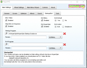

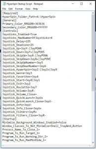

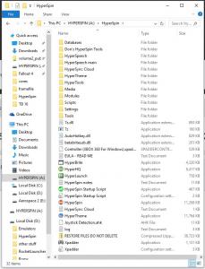

digitalbilly Posted January 10, 2016 Author Posted January 10, 2016 Thanks for the link to the script. Ive been trying to get this to work but I am not sure what step I am missing. I have noticed that in this forum - where the HyperSpin Startup script is downloaded from there are 3 files in his attacment. and I am not sure if those other attachments are needed and where they go as instructions are not that clear to me. http://www.hyperspin-fe.com/topic/9028-hyperspin-startup-script-108/ HS Startup.zip, HyperSpin Startup Script.zip, Joystick Detection.ahk here is what i have done so far. I have saved and extracted the script to the root of my hyperspin folder. i have added the exe to hyperhq startup program as seen as in the picture in the attachments. "HyperHQ, Go to Main Settings -> Startup\Exit HyperSpin Startup Script.exe" here is a copy of my "HyperSpin Startup script.ini" [Required] HyperSpin_Folder_Path=.\ [General] Primary_Color_RRGGBB=363636 Secondary_Color_RRGGBB=ffffff [Controls] Joysticks_Enabled=ture Joysticks_MaxNumberOfJoysticks=4 Joystick_Delay=225 Joystick_Deadzone=25 Joystick_Up=JoyY-|JoyPOVN Joystick_Down=JoyY+|JoyPOVS Joystick_SkipUp=JoyX-|JoyPOVW Joystick_SkipDown=JoyX+|JoyPOVE Joystick_SkipUpNumber=Joy5 Joystick_SkipDownNumber=Joy6 Joystick_HyperSpin=JoyZ-|JoyZ+|Joy9 Joystick_Genre=Joy3 Joystick_Favorites=Joy4 Joystick_Start=Joy1 Joystick_Exit=Joy2 Joystick_Roulette=Joy7 Joystick_Volume=JoyR- Joystick_Volume_Close= Joystick_QuickLaunch=JoyU+ Joystick_QuickLaunch_Close=JoyU- Joystick_Info=JoyU- Joystick_Info_Close=JoyU+ Joystick_Filters=JoyR+ Joystick_Filters_Close=JoyR- [startup] Minimize_Background_Windows_Enabled=false Window_Classes_To_Not_Minimize=Shell_TrayWnd,Button Process_Name_To_Close_1= Program_To_Run_Target_1= Program_To_Run_Working_Dir_1= Program_To_Run_MaxMinHide_1= [Exit] Restore_Windows_On_Exit=True Process_Name_To_Close_1= Program_To_Run_Target_1= Program_To_Run_Working_Dir_1= Program_To_Run_MaxMinHide_1= [Roulette] Roulette_Key=~1 Roulette_Min_MilliSeconds=3000 Roulette_Max_MilliSeconds=8000 [Volume_Menu] Volume_Menu_Key=~2 Volume_Bar_Offset_From_Bottom=44 [QuickLaunch] QuickLaunch_Key=~3 QuickLaunch_Enabled=true QuickLaunch_Left_Offset=5 QuickLaunch_Top_Offset=10 QuickLaunch_Bottom_Offset=10 Item_1_Path= Item_1_Parameters= Item_1_LogoPath= Item_1_Ignore_Process_Close=false
kylecp1979 Posted January 10, 2016 Posted January 10, 2016 Run the script once and I used an absolute path to the script A:\HyperSpin

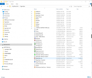

digitalbilly Posted January 10, 2016 Author Posted January 10, 2016 ok I have ran the script once and made some changes but still having issues getting the controller to work. I have made changes to the ini file to point to hyperspin via absolute path here is my ini file: [Required] HyperSpin_Folder_Path=H:\HyperSpin [General] Primary_Color_RRGGBB=363636 Secondary_Color_RRGGBB=ffffff [Controls] Joysticks_Enabled=True Joysticks_MaxNumberOfJoysticks=4 Joystick_Delay=225 Joystick_Deadzone=25 Joystick_Up=JoyY-|JoyPOVN Joystick_Down=JoyY+|JoyPOVS Joystick_SkipUp=JoyX-|JoyPOVW Joystick_SkipDown=JoyX+|JoyPOVE Joystick_SkipUpNumber=Joy5 Joystick_SkipDownNumber=Joy6 Joystick_HyperSpin=JoyZ-|JoyZ+|Joy9 Joystick_Genre=Joy3 Joystick_Favorites=Joy4 Joystick_Start=Joy8|Joy1 Joystick_Exit=Joy2 Joystick_Roulette=Joy7 Joystick_Volume=JoyR- Joystick_Volume_Close= Joystick_QuickLaunch=JoyU+ Joystick_QuickLaunch_Close=JoyU- Joystick_Info=JoyU- Joystick_Info_Close=JoyU+ Joystick_Filters=JoyR+ Joystick_Filters_Close=JoyR- [startup] Minimize_Background_Windows_Enabled=false Window_Classes_To_Not_Minimize=Shell_TrayWnd,Button Process_Name_To_Close_1= Program_To_Run_Target_1= Program_To_Run_Working_Dir_1= Program_To_Run_MaxMinHide_1= [Exit] Restore_Windows_On_Exit=True Process_Name_To_Close_1= Program_To_Run_Target_1= Program_To_Run_Working_Dir_1= Program_To_Run_MaxMinHide_1= [Roulette] Roulette_Key=~1 Roulette_Min_MilliSeconds=3000 Roulette_Max_MilliSeconds=8000 [Volume_Menu] Volume_Menu_Key=~2 Volume_Bar_Offset_From_Bottom=44 [QuickLaunch] QuickLaunch_Key=~3 QuickLaunch_Enabled=true QuickLaunch_Left_Offset=5 QuickLaunch_Top_Offset=10 QuickLaunch_Bottom_Offset=10 Item_1_Path= Item_1_Parameters= Item_1_LogoPath= Item_1_Ignore_Process_Close=false
digitalbilly Posted January 10, 2016 Author Posted January 10, 2016 for whatever reason a reboot fix my issue after verifying my settings in the .ini I have it working for the most part but I am still having a issue with the script. is the script able to exit out of emulator to go back to the wheel menu without the use of a esc key on keyboard??
