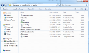

peter.gurris Posted July 4, 2015 Posted July 4, 2015 Hi, I'm having problems setting up a second controller in xpadder. I was able to set up my ps4 controller without any problems, however recently I plugged in a Buffalo SNES controller (8 button USB controller) each time I try to start a game I get the following error message. Please create a xpadder controller profile name either USB,2-axis 8button gamepad. or it also needs to be in the same folder as xpadder.exe The thing is I have created a profile USB,2-axis 8button gamepad and placed it in the folder. Is there an ini setting that somehow is not seeing the folder where I placed it??? Taking the controller out fixes the problem with hyperspin but I want to use my SNES controllers Any help would be greatly appreciated!!!!
