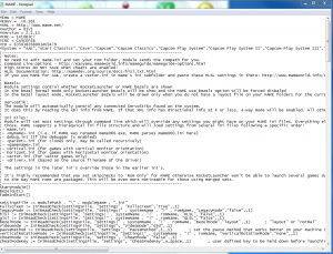

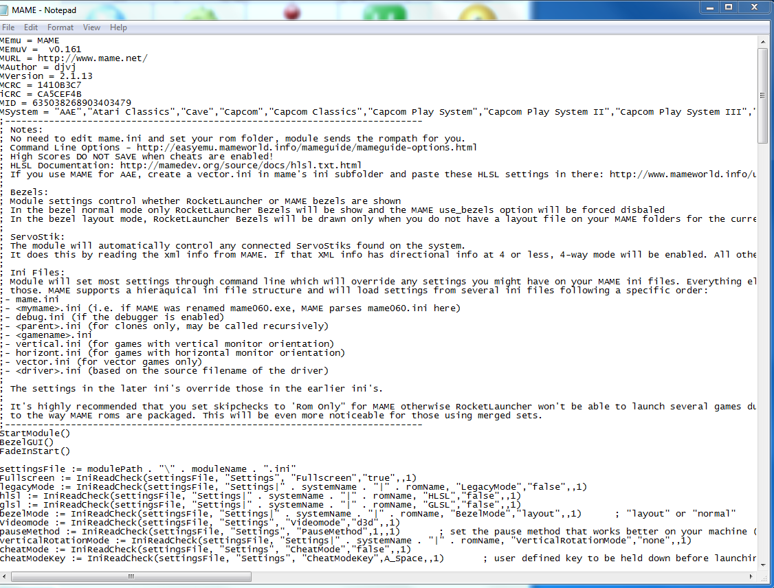

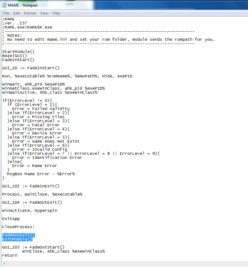

The attached files show the difference between my mame.ahk from a previous setup, and the one that came with rocketlauncher. I just had to add the below lines to my mame.ahk file.
StartModule()
BezelGUI()
FadeInStart()
FadeOutExit()
ExitModule()
