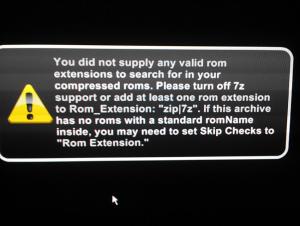

In the last minute I decided to try installing the Commodore Amiga system and when I tried to test the other working systems appeared the error message "You did not supply any valid rom extensions..." (attached printscreen).
Can anyone help me to fix and understand what might have happened?

Within rocketlauncher , under the commodora amiga system check 7z is not enabled. It should be disabled.
MAME High Score Tutorial For HyperSpin    :alberteinstein:
No problem.
FIY I have 7z disabled under global settings and just enable it on a per system as needed basis not the other way around.
