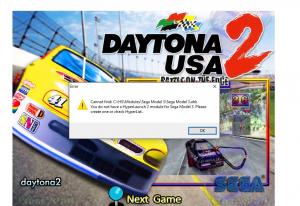

titophy Posted January 1, 2016 Posted January 1, 2016 Bonsoir à tous, j'utilise hyperspin 1.4, j'ai copier le module de sega model 2 et 3 et j'ai le message suivant pour les 2: Cannot find ....., please create one or check hyperlist. Merci Bonne Année

shinobi68 Posted January 15, 2016 Posted January 15, 2016 D'après ton premier log, il cherche hyperlaunch.exe sous d:\hyperspin. C'est là que ça plante. Il devrait chercher rocketlauncher. T'as quelle version d'hyperspin? Je pourrais pas t'aider ce week-end, mais je pense que c'est là qu'il faut creuser... Au pire, lundi je pourrais verifier le log chez moi pour comparer.
titophy Posted January 15, 2016 Author Posted January 15, 2016 ici en mettant executable, rom path et extension : zip dans hyper HQ jen'ai rien mis dans params: 06:54:04 AM | HyperSpin Started 06:54:04 AM | Going windowed mode 06:54:04 AM | Checking for updates 06:54:04 AM | Update Check Complete 06:54:04 AM | Startup program unavailable 06:54:04 AM | Playing intro video 06:54:05 AM | Menu Mode is multi 06:54:05 AM | Loading Main Menu.xml 06:54:05 AM | Main Menu.xml successfully loaded 06:54:06 AM | Main Menu wheel loaded successfully 06:54:07 AM | Loading Sega Model 2.xml 06:54:07 AM | Main Menu.xml successfully loaded 06:54:08 AM | Sega Model 2 wheel loaded successfully 06:54:09 AM | Launching Game 06:54:09 AM | Not using HyperLaunch 06:54:09 AM | Running in normal rom mode 06:54:09 AM | Excecutable is emulator.exe 06:54:09 AM | Command Line is: "D:\HyperSpin\Emulators\Emulators\Sega Model 2\emulator.exe" "D:\HyperSpin\Emulators\Sega Model 2\roms\daytona.zip" 06:54:21 AM | Loading Main Menu.xml 06:54:21 AM | Main Menu.xml successfully loaded 06:54:21 AM | Main Menu wheel loaded successfully 06:54:22 AM | Exit program unavailable 06:54:22 AM | Quiting Hyperspin 06:54:22 AM | Bye! merci bonne journée
titophy Posted January 15, 2016 Author Posted January 15, 2016 voilà le log : 06:49:20 AM | HyperSpin Started 06:49:20 AM | Going windowed mode 06:49:20 AM | Checking for updates 06:49:20 AM | Update Check Complete 06:49:20 AM | Startup program unavailable 06:49:20 AM | Playing intro video 06:49:22 AM | Error intializing joysticks 06:49:22 AM | Menu Mode is multi 06:49:22 AM | Loading Main Menu.xml 06:49:22 AM | Main Menu.xml successfully loaded 06:49:23 AM | Main Menu wheel loaded successfully 06:49:23 AM | Loading Sega Model 2.xml 06:49:23 AM | Main Menu.xml successfully loaded 06:49:24 AM | Sega Model 2 wheel loaded successfully 06:49:25 AM | Launching Game 06:49:25 AM | Using HyperLaunch 06:49:26 AM | Getting Launcher path 06:49:26 AM | Can't find HyperLaunch, defaulting to root HyperLaunch.exe 06:49:26 AM | Launcher located at D:\HyperSpin\HyperLaunch.exe 06:49:26 AM | Running Launcher 06:49:26 AM | Launcher Command Line is: D:\HyperSpin\HyperLaunch.exe "Sega Model 2" "daytona" 06:49:26 AM | Launching Game 06:49:26 AM | Using HyperLaunch 06:49:26 AM | Getting Launcher path 06:49:26 AM | Can't find HyperLaunch, defaulting to root HyperLaunch.exe 06:49:26 AM | Launcher located at D:\HyperSpin\HyperLaunch.exe 06:49:26 AM | Running Launcher 06:49:26 AM | Launcher Command Line is: D:\HyperSpin\HyperLaunch.exe "Sega Model 2" "daytona" 06:49:27 AM | Launching Game 06:49:27 AM | Using HyperLaunch 06:49:27 AM | Getting Launcher path 06:49:27 AM | Can't find HyperLaunch, defaulting to root HyperLaunch.exe 06:49:27 AM | Launcher located at D:\HyperSpin\HyperLaunch.exe 06:49:27 AM | Running Launcher 06:49:27 AM | Launcher Command Line is: D:\HyperSpin\HyperLaunch.exe "Sega Model 2" "daytona" 06:49:27 AM | Launching Game 06:49:27 AM | Using HyperLaunch 06:49:27 AM | Getting Launcher path 06:49:27 AM | Can't find HyperLaunch, defaulting to root HyperLaunch.exe 06:49:27 AM | Launcher located at D:\HyperSpin\HyperLaunch.exe 06:49:27 AM | Running Launcher 06:49:27 AM | Launcher Command Line is: D:\HyperSpin\HyperLaunch.exe "Sega Model 2" "daytona" 06:49:28 AM | Launching Game 06:49:28 AM | Using HyperLaunch 06:49:28 AM | Getting Launcher path 06:49:28 AM | Can't find HyperLaunch, defaulting to root HyperLaunch.exe 06:49:28 AM | Launcher located at D:\HyperSpin\HyperLaunch.exe 06:49:28 AM | Running Launcher 06:49:28 AM | Launcher Command Line is: D:\HyperSpin\HyperLaunch.exe "Sega Model 2" "daytona" 06:49:28 AM | Launching Game 06:49:28 AM | Using HyperLaunch 06:49:28 AM | Getting Launcher path 06:49:28 AM | Can't find HyperLaunch, defaulting to root HyperLaunch.exe 06:49:28 AM | Launcher located at D:\HyperSpin\HyperLaunch.exe 06:49:28 AM | Running Launcher 06:49:28 AM | Launcher Command Line is: D:\HyperSpin\HyperLaunch.exe "Sega Model 2" "daytona" 06:49:28 AM | Launching Game 06:49:28 AM | Using HyperLaunch 06:49:28 AM | Getting Launcher path 06:49:28 AM | Can't find HyperLaunch, defaulting to root HyperLaunch.exe 06:49:28 AM | Launcher located at D:\HyperSpin\HyperLaunch.exe 06:49:28 AM | Running Launcher 06:49:28 AM | Launcher Command Line is: D:\HyperSpin\HyperLaunch.exe "Sega Model 2" "daytona" 06:49:28 AM | Launching Game 06:49:28 AM | Using HyperLaunch 06:49:28 AM | Getting Launcher path 06:49:28 AM | Can't find HyperLaunch, defaulting to root HyperLaunch.exe 06:49:28 AM | Launcher located at D:\HyperSpin\HyperLaunch.exe 06:49:28 AM | Running Launcher 06:49:28 AM | Launcher Command Line is: D:\HyperSpin\HyperLaunch.exe "Sega Model 2" "daytona" 06:49:28 AM | Launching Game 06:49:28 AM | Using HyperLaunch 06:49:28 AM | Getting Launcher path 06:49:28 AM | Can't find HyperLaunch, defaulting to root HyperLaunch.exe 06:49:28 AM | Launcher located at D:\HyperSpin\HyperLaunch.exe 06:49:28 AM | Running Launcher 06:49:28 AM | Launcher Command Line is: D:\HyperSpin\HyperLaunch.exe "Sega Model 2" "daytona" 06:49:28 AM | Launching Game 06:49:28 AM | Using HyperLaunch 06:49:28 AM | Getting Launcher path 06:49:28 AM | Can't find HyperLaunch, defaulting to root HyperLaunch.exe 06:49:29 AM | Launcher located at D:\HyperSpin\HyperLaunch.exe 06:49:29 AM | Running Launcher 06:49:29 AM | Launcher Command Line is: D:\HyperSpin\HyperLaunch.exe "Sega Model 2" "daytona" 06:49:29 AM | Launching Game 06:49:29 AM | Using HyperLaunch 06:49:29 AM | Getting Launcher path 06:49:29 AM | Can't find HyperLaunch, defaulting to root HyperLaunch.exe 06:49:29 AM | Launcher located at D:\HyperSpin\HyperLaunch.exe 06:49:29 AM | Running Launcher 06:49:29 AM | Launcher Command Line is: D:\HyperSpin\HyperLaunch.exe "Sega Model 2" "daytona" 06:49:29 AM | Launching Game 06:49:29 AM | Using HyperLaunch 06:49:29 AM | Getting Launcher path 06:49:29 AM | Can't find HyperLaunch, defaulting to root HyperLaunch.exe 06:49:29 AM | Launcher located at D:\HyperSpin\HyperLaunch.exe 06:49:29 AM | Running Launcher 06:49:29 AM | Launcher Command Line is: D:\HyperSpin\HyperLaunch.exe "Sega Model 2" "daytona"

shinobi68 Posted January 1, 2016 Posted January 1, 2016 Salut, Tu utilises une vieille version du lanceur (hyperlaunch). Pas la peine de batailler avec ça, passe sous rocketlauncher. Le jeu en vaut la chandelle. Va voir le site officiel de rocketlauncher pour en savoir plus. Il faut un peu de temps au début, mais après avoir configuré un ou deux systèmes, ça ira vite. Tu n'auras plus tellement de soutien avec hyperlaunch et la plupart des émulateurs n'auront pas de script pour fonctionner avec cette vieille version. Rocketlauncher est devenu incontournable. Ce qui est bien, c'est qu'il est indépendant du front-end. Donc une fois tes systèmes paramétrés, tu pourras utiliser d'autres front-end et pas forcément hyperspin. Bon courage
