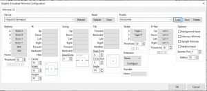

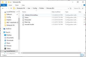

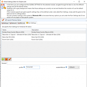

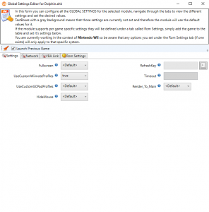

I am having serious trouble trying to get this to work I can't find any info either. I have followed the notes but I still can't get it to work. I'm trying to use a 360 pad with my wii and wiiware games. Here are the notes from Rocketluncher
