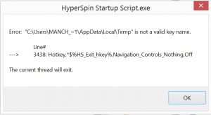

I was installing some new systems on my setup and I got this error. I don't know how to go about fixing it.
Here is my startup script ini

So you're getting this when you just try to open HyperSpin in general? Which version are you using?
Also, what specifically did you change since it last worked correctly?
Bliss_Box_Signature.png    Facebook_Sub_Zero.png    Twitter_Sub_Zero.png   Steam_Sub_Zero.png          Patreon.png.38e50cc7f1cd89d35a7558647ecc9f6c.png
I'm using 1.4 Not sure what changed I installed lots of older systems late 70's early 80's. I get this error the first time I start hyperspin. Then when I close hyperspin the startup script stays open. If I start hyperspin again I get no error and the startup script is still open. I only get the error when I close the start up script and start hyperspin up.
Only thing I can think of is that there's something wrong in your settings, or there's a third part program causing issues because I don't recognize "HyperSpin Startup Script.exe." Under HyperHQ -> Main Settings -> Startup/Exit is there anything defined in the "Startup Program" box?

The program is 3rd party, it's ghutch's Startup Script for controller mapping. The exe is set in HyoerHQ for the Startup Program. I use it myself, but never had any issues with it.
That makes sense.
It was my hyperspeech I reinstalled it and now everything is running fine again. Thanks for your help guys or girls.
