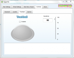

ScoobaSteveo Posted March 30, 2016 Posted March 30, 2016 So. I've dealt with all HyperSpin wheels jumping one game when I launched a game in any system [MAME, NES, Genesis, etc...] for a very long time...years. I attempted to change the HyperSpin --> Settings --> MAME.ini --> game_jump setting to "0" to no avail. The game jump in HyperSpin was persistent. I attempted to change the game jump setting in HyperHQ to zero but the lowest value is one. Then I got to thinking that I rarely use my control panel's trackball to navigate within HyperSpin so I disabled it. That seems to have eliminated the game jump problem. For those who skim through threads: To halt HyperSpin wheels from jumping one game go into HyperHQ and disable your trackball. Controls tab then Trackball tab Next problem to figure out...enabling lightguns in MAME 0.166 for Non-MAME systems. Lightguns function nicely in MAME...
JoyStickKilla Posted March 30, 2016 Posted March 30, 2016 erratic wheel behavior is very well known when having trackball,spinner or joypad enabled. Not as bad after the 1.4 update but still happens.
