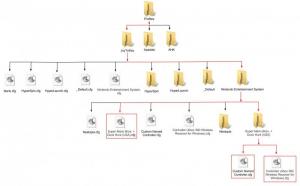

1.) you need the latest version of hyperlaunch (from git and not the downloads section) Installing and updating using git
2.) look at the keymapper documentation. The above picture is outdated.
3.) look at the pictures in the keymapper documentation.
4.) You'll need to run joytokey on HyperSpin Startup or Windows startup to have joytokey enabled when you first use HyperSpin. You can use my HyperSpin Startup Script for this.

So it seems that when HyperLaunch starts JoytoKey, it (JoytoKey) is only able to access profiles contained within the folder where JoytoKey resides.
I have JoytoKey located in HyperSpin\Utilities\JoytoKey\ (and HyperLaunch is aware of this).
When I create profiles using HyperLaunch, they are created in HyperSpin\HyperLaunch\Profiles\JoytoKey\
When I start Nestopia using HyperSpin, JoytoKey is successfully started by HyperLaunch, but the only profile in the list is the generic profile contained in \HyperSpin\Utilities\JoytoKey\
So, when HyperLaunch starts JoytoKey, is it supposed to pass the name of the configuration file to it, for example ...JoytoKey.exe "HyperLaunch\Profiles\%keymapper%\%systemName%\%systemName%.cfg"
Perhaps this doesn't work in newer versions of JoytoKey?
If I copy all of my profile cfg files to ...\Utilities\JoytoKey\ they are then available to JoytoKey, but HyperLaunch doesn't seem to be able to tell JoytoKey which profile to use, instead the first profile in the list is selected.
I can't imagine everyone who is successfully using JoytoKey is running development builds using Git. It seems more likely that perhaps a recent change to JoytoKey broke something. I'm using version 5.4.1.

I looked at j2kTEMP.cfg and it still has the settings for HyperSpin.cfg. I then tried manually running "JoyToKey C:\HyperSpin\HyperLaunch\j2kTEMP.cfg" from the command line and it correctly loaded the profile.
For some reason, this step isn't working.
Note: the spaces you see between words above is a formatting issue of this site, the spaces are not in the original log.
You will definitely need to upgrade to get j2k to work. There is a nasty bug in HL v3.0.9 dealing with joy2key that was fixed in the next version of HL.
Possibly, although I was able to get it to work as is.
Basically, if you copy/move JoytoKey to ..\HyperSpin\HyperLaunch\ (the same folder as j2kTEMP.cfg) then everything works as it should. You also need to update HyperLaunch with the new exe location.
It boils down to JoytoKey only accepting config files from files located in the folder where it is operating. You can force it to load j2kTEMP.cfg manually, but once HyperLunch goes to switch it, it reverts back to the operating folder where JoytoKey.exe is located and then it can only see the config files in that folder (the problem that I was having).
If you want to ensure that the HyperSpin.cfg is loaded on boot, I copied HyperSpin.cfg to ..\HyperSpin\HyperLaunch\ and run "C:\HyperSpin\HyperLaunch\JoytoKey.exe HyperSpin.cfg" on boot. After that HyperLaunch can take over and all is good.

Well I am finally up and running and it is all thanks to ghutch92. The main problem I had was I could not get my U360 joysticks to work with the wheel within HS. Here is what we did to fix that problem.
First we went through his tutorial located here: http://www.hyperspin-fe.com/forum/showthread.php?29214-Lost-in-translation/page2
Once we had everything updated and set up in that tutorial we went into the HLHQ configuration and set up the menus for Xpadder. This was the part that threw me off before and as ghutch9 could tell, it wasn't pretty. This is what my xpadder settings looked like under the HLHQ Global Keymapper settings:
2h2hap4.jpg[/img]
After that ghutch told me how and why my wheels still wouldn't work upon start up of HS but rather only until after I exited out of the first game. He explained that HL doesn't launch until a game is launched....that way my controls would work afterwards. However, I needed it to work right away as well. He then pointed me to this script he wrote which worked perfectly. http://www.hyperspin-fe.com/forum/showthread.php?28986-HyperSpin-Startup-Script
The only thing I changed was changing the keymapper enabled = false to = true. I then had to enable it within Hyper HQ. It looks like this:
After that, everything is working great and I can finally close up my cabinet after all this time.....(well after I figure out Daphne, that is a whole other beast).
