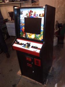

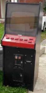

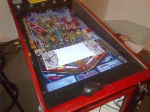

Luckydogg420 Posted March 3, 2014 Author Posted March 3, 2014 Well I made the mistake of putting the tv into the cabinet to "test" things out..... and then just started playing games, instead of getting any real work done. Then I had a side project to do quickly. My Boss' wife called me on a Tuesday night, and said that they "might" want a mame cabinet for their sons birthday, the following Thursday. They were still thinking about it, and were wondering the cost ect. She seemed very excited and just wanted to talk with her husband (my boss) about it. She said she'd get back to me by Friday. Like a Mame cabinet is easy to build in a week. Fortunately I have been in the hobby for a while and had an empty cabinet in my garage. It used to be a blackjack game and would work nicely for a small 2 player machine. I also had an ipac2, 17" LCD, two joysticks, and a bunch of buttons laying around. So I decided to get the cabinet as far as I could with parts that I had on hand. The empty cabinet was found on the side of the road months ago....like some people think this stuff is trash. I re painted it with supply's from the pinball machine. Black and red, it's a classic. I then went to walmart and bought 2 posters to add the graphics. Here's a quick before and after I didn't document the process, but ask if there's any questions.

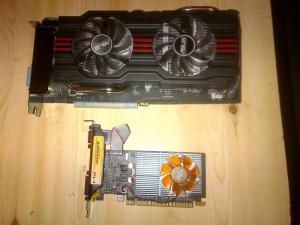

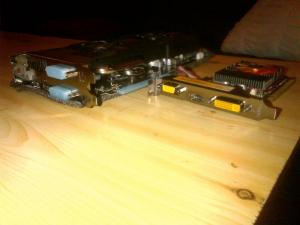

Luckydogg420 Posted March 3, 2014 Author Posted March 3, 2014 It wasn't long after loading a few tables and playing a few games that I decided to improve the graphics card. The PC that I bought came with a GeForce GT 610 2gb. This works better on some tables then others, but during multiball things would get hard to keep track of. The balls would jump across the cable. On fast shots around the loop the ball would be gone and impossible to track. IMHO. Software is my weak point and I'm sure that this machine could have better performance with some set up work done to it. So I decided to upgrade the graphics card. After looking at other peoples build threads I noticed the 660 was used by others. This seems to be the next level of graphics cards without spending $700 + on a card. This is the one that I bought. http://www.canadacomputers.com/product_info.php?cPath=43_1200_557_559&item_id=053246 It's easy to see the difference in the two cards. This should be awesome time ten.

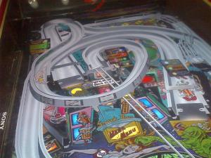

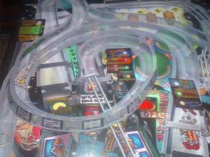

Luckydogg420 Posted March 11, 2014 Author Posted March 11, 2014 I had only tried the GeForce 610 with ghostbusters and wooly. I didn't play with it to long, and I assume if someone knew anything about tweaking the system they could have better performance. In VP the video options changed it a bit, think I un checked the box's for (I think) "ffx" and "hardware something". (I'm not in front of the machine while weighting this) It was worse on the gb table, but it could have been software related. There was a preloaded copy of asus windows software (with all the crap installed with it) on the computer. That video card can only register 2 monitors and the bios wouldn't allow me to turn on the integrated graphics while a video card was installed. So I needed to do something better. I tried the usb-VGA converter for the 3rd screen, but that really messed with things. As soon as it was plugged in the nvidea control panel software stopped working properly. Something is not compatible. Here's 2 pictures of creature from the black lagoon. The ramps are solid in one, and transparent in the other. I'm not sure what was causing this to happen, but assume its from the 3rd screens USB-VGA device.
Luckydogg420 Posted March 11, 2014 Author Posted March 11, 2014 So, I got a new motherboard. Now I will be able to run both cards at once. The GTX 660 for playfield and the GT 610 for backglass and DMD. I also plan to do a fresh install of win7. Not the asus windows recovery disks. This should fix all problems that I've been having.

boogies2 Posted March 12, 2014 Posted March 12, 2014 THOUGHTS of what is happening: The USB card uses the CPU - and that is bad for the GPU. The GPU recognizes 3 monitor and trys to allocate the memory. The problem is that the USB is not even using the GPU. REALITY of what is happening: I have heard nothing but bad things with all USB video ports being used as third monitors. Kinda late now, but I believe that if you have MB with only 1 PCI-E, it might be cheaper to get a Real LED-DMD with a PinDMD2 (approx $400) than to upgrade the MB, CPU and add the video cards. If starting fresh, the dual PCI-E is the most economical (with powerful results) way to go. Running VPinMame in the third window doesn't require too much, and your 610 might be adequete. Try the 610 with only the DMD. Use your 660 for the PF and the BG. I am using a 480 for the PF and BG and it's been running every table at full speed. I believe that a 480 and 660 should be pretty close in a comparison of GPU power.
