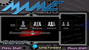

RumblesArcade Posted May 3, 2016 Posted May 3, 2016 Hey guys, I had all my emulators running games nicely, I set Mame up first and now after setting a few other emulators up, Mame now comes up with new select menu after i select game (see picture), i select one of the options but nothing happens just goes back to game list and wont load games. All other emulators still work and dont have this menu come up I did the auto update on rocketlauncher so maybe something i have to change, More than likely something i did or pressed somewhere, can anyone help me out with this?
bleasby Posted May 4, 2016 Posted May 4, 2016 It has nothing to do with doing the update. No user settings are touched when you update RocketLauncher. You, most probably, just enabled by yourself the multiplayer link feature from RocketLauncher. Open RocketLauncherUI, select your system, select the mame module and inside the module options disable the link play option. When asking for help for RocketLauncher, POST ON THE RLAUNCHER.NET FORUMS! Also, please post your RocketLauncher.log with logging level set to troubleshooting in pastebin (set the log level in RocketLauncherUI, global system > General Settings -> RocketLauncher). Ass. Bleasby - RocketLauncher Development Team.
RumblesArcade Posted May 4, 2016 Author Posted May 4, 2016 Thanks for your help bleasby, I went into mame module in RocketLauncherUI and had a look at the link play and was set to default. I tried changing tab to disable but menu still coming up when trying to launch game in Hyperspin. tried both ways multiple times (disable and default).
bleasby Posted May 4, 2016 Posted May 4, 2016 It is definitely the multiplayer menu. You are just not finding the option to toggle. Create a post on the RocketLauncher forum and add your log at troubleshooting level there and I will keep helping you until you find it. When asking for help for RocketLauncher, POST ON THE RLAUNCHER.NET FORUMS! Also, please post your RocketLauncher.log with logging level set to troubleshooting in pastebin (set the log level in RocketLauncherUI, global system > General Settings -> RocketLauncher). Ass. Bleasby - RocketLauncher Development Team.
