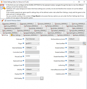

Jokerbone Posted May 11, 2016 Posted May 11, 2016 i'm trying to get Spawn to launch through Demul (Naomi) but I keep getting an error on Hyperspin that tells me to run the emulator with direct x 10 first in order to create the gpudx10.ini. However, when I run it directly through the emulator (bypassing Hyperspin), it launches fine. Going to try to download dx10 tomorrow to see if it will get added to the drop down config menus in Demul, but wanted to see if there was anything that needed to be changed on the front end since it launches independently. It's currently set to use dx11
kylecp1979 Posted May 11, 2016 Posted May 11, 2016 See if your rocketlauncher setting are set to gpuDX11 if that is what your using.
Jokerbone Posted May 11, 2016 Author Posted May 11, 2016 Everything was set to defaults but I changed the plugin to DX11. However still having the issue. FYI, I did change the plugin for all modules. Again, this is only happening with Spawn in the Demons Hand. Everything else works fine
kylecp1979 Posted May 11, 2016 Posted May 11, 2016 ok click on rom setting tab and see if you just have gpuDX10 set for that rom.
