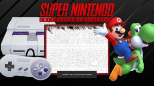

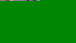

Just bought a new laptop and copied my existing hyperspin set-up over to it. Upon starting hyperspin all the video snaps are garbled. At first I thought I must be missing the necessary codecs, so I downloaded the recommended codecs listed on emumovies, and when that didn't help the situation I downloaded ffdshow. Problem remains. I went to the video snaps using windows explorer and test ran the videos using Windows Movie Player. Low and behold the videos worked just fine. I looked to see what the default video player was and it was Movies and TV. So I test ran the videos in that application and they worked just fine there too.
So I am kind of stumped as to why the videos won't run correctly in Hyperspin but just fine in Windows Movie Player and Movies and TV. Hyperspin set-up works fine on my previous laptop, my gaming PC, and wife's laptop. I also tried the "Run as Administrator" option with hyperspin, same issue prevailed. Any ideas or assistance would be greatly appreciated.

Attaching demonstration pictures. The all green video is the front end intro.flv video
Updated GTX970m GPU Driver to the latest that came out on the 13th (365.19) - problem remains
Checked and the Intel HD Graphics 530 driver is already up to date.
Made an exception for the entire Hyperspin directory to be excluded in ESET Smart Security - problem remains
Downloaded the new Hyperspin 1.4 r015 upgrade (I was on 1.33) -  appears to have solved problem!
