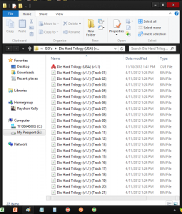

For some reason my games which come in multiple ".bin" files will not work. Games with only one .bin file and one .cue file works just fine. Does anyone know what's the issue?
Example of a game which will not work:

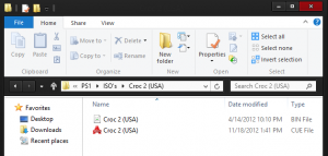

Example of a game which does work:
[ATTACH=CONFIG]37846[/ATTACH]
[ATTACH=CONFIG]37847[/ATTACH]

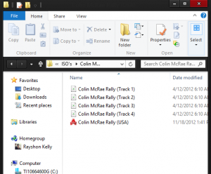

Understood, but that still doesn't rule out the order for your HL. When loading the roms outside HS, are you loading the bin or cue files?? If there are multiple bins, you have to load the cue. If only one bin, then that one bin has all the tracks in it (or it's a single track disk). Therefore it would work if you loaded the bin or the cue. Same in HyperSpin. If you loaded a bin file for a rom that has multiple bin files, I would imagine it would not work at all. For that same rom, if the cue file was good, it would work if you loaded the cue from the emulator or if HL loaded the cue before it tried to load the bin.

I ruled that out and have HL set to only use cue with 7z enabled and all the single bin games (with matching cue) have no problem. I extracted about 5 individual games with multi bin and tried launching the cue directly from Mednafen and they wouldn't launch. The single bin files launched no issue (I stopped testing after 5 or so again). Mednafen doesn't even have bin as an extension for me and I don't remember removing it but it's possible. Anyways I've still had a few games that have issues after conversion to single bin but I haven't done any further testing on the matter as converting seems to have about 80-90% success.
