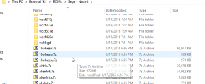

  • Games Launch with RocketLauncher even though a game audit shows every rom red.
  • All of my CHD files are in their respected unzipped folders.
  • All of my Rom files are Zipped still.

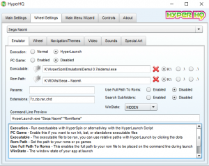

  • I'm not 100% positive I have my Hyperspin HQ setup correct for this Emulator.

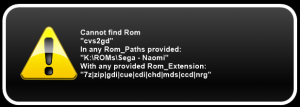

  • I'm probably missing something simple but this is the error i'm getting. I have tried to change the chd file name to match what it is asking for but then it says it can't find the ini file with the original file name associated with it.

I think i'm getting closer on this. I deleted the entry I made for Sega Naomi in HyperHQ. Now at least I can get a game launched. It just takes forever.

You should never rename CHDs or MAME rom files. For Naomi you should have the "Skip Checks" setting in RocketLauncherUI set to "Roms Only". That way RL won't look for the rom file avoiding the error and Demul will load the game just fine. Also make sure that you have the "7z enabled" setting set to false on the Settings tab, that's another common cause of problems for arcade based systems.
If you're still not able to launch the games set your "Logging Level" to Troubleshooting on the General Settings -> RocketLauncher tab in RLUI, run a game, and post the RocketLauncher.log file which is created in your RocketLauncher folder.
Some other things to note: since you're using RL you don't need to fill in the "Executable" field in HyperHQ because it will never be used. You also don't need to fill in the "Rom path" or "Extensions" fields in HyperHQ unless you're using the Roms Only filter. None of those 3 settings are used for launching games because you're using RocketLauncher.
