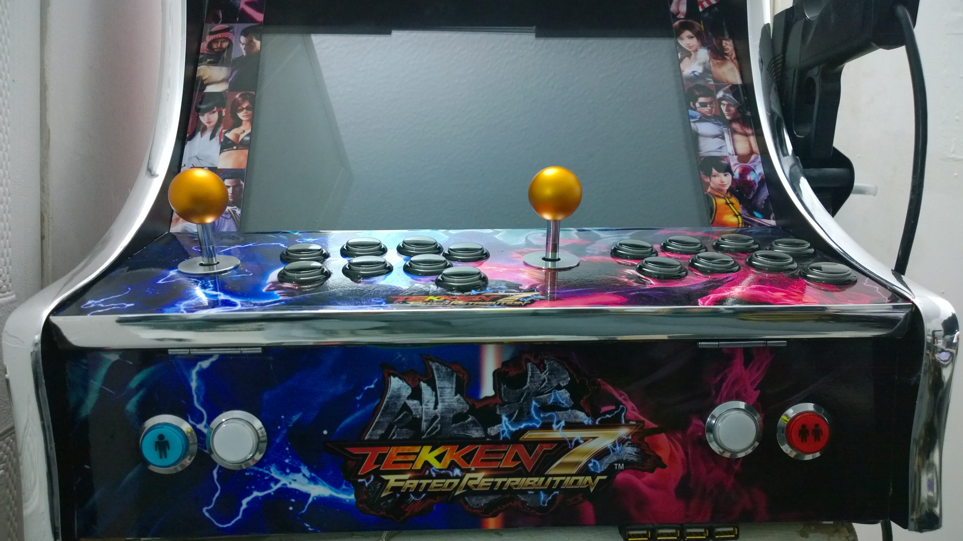

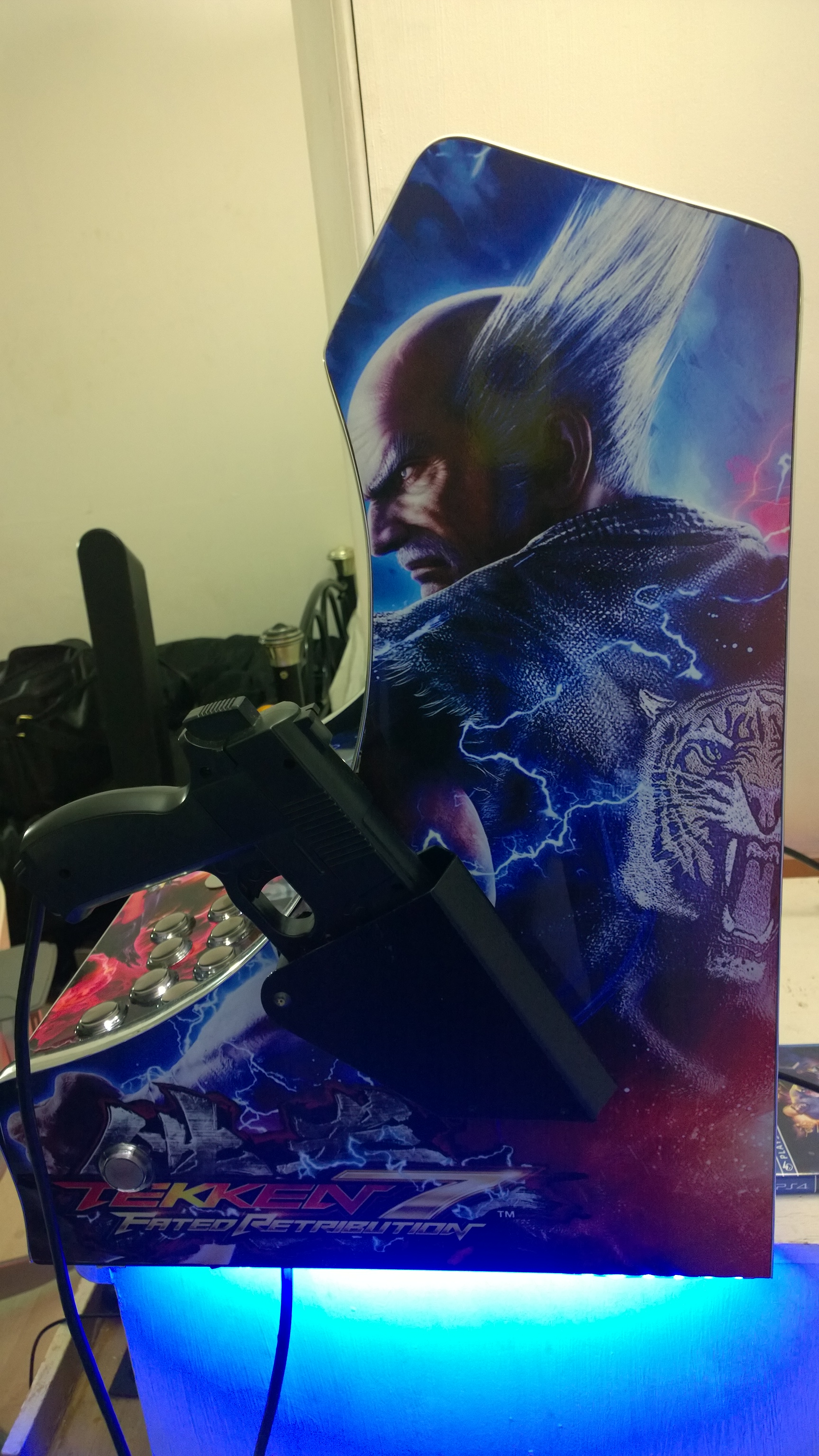

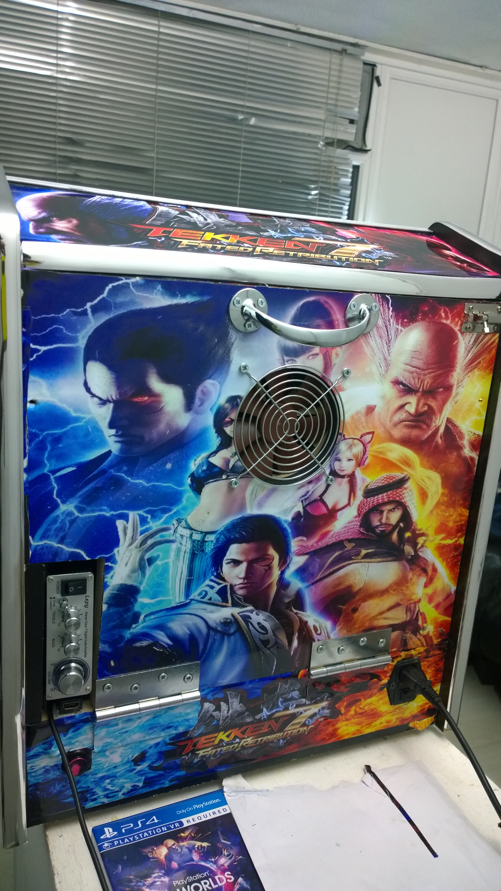

Just finished my 4-5 month bartop cab project (Just doing some software tweaks and making sure everything works)  All in all, I'm pretty happy how it turned out (It went through a LOT of iterations...it was initially meant to be a TMNT inspired cab lol.  I made a few mistakes due to not building anything since I was playing around with technic lego decades ago, like putting hinges on the outside of the door (had this idea at the end of putting everything together and couldn't be bothered to take it apart  to install the hinges lol) but I'm happy.  All there is do to do now is implement some ideas I have to the software, find out how the hell to use LED Blinky, create some custom collections, try to get Hypersearch to work, change that annoying TTS windows 7 voice so  Hyperspeech doesn't sound so annoying and wait for the PC release of Tekken 7 :-)
SPECS:
z170m Plus Mini ATX Board
I5 6600K 3.5ghz quad core Processor (will try to overclock it to 4Ghz this week)
Noctua NH-L12 CPU Cooler
Noctua NF-F12PWM case fan X2
EVGA Geforce GTX 750 Ti Graphics card (May upgrade to GTX 1060 on Tekken 7 release)
16GB DDR4 Ram
5TB 7200rpm HD
250GB Samsung SSD
NEC 19inch IPS Monitor
Metallic gold Sanwa Sticks
18 Seimitsu 'Halo illuminated effect buttons'
Aimtrack Light Gun and infra red bar
Recoil module for gun
2 USB 3.0 Hubs
HDMI out
Bluetooth dongle
Wireless Dongle
Lepy Amplifier
Car speakers
....and blood, sweat, wiring and a new found appreciation for electricians and carpenters!
