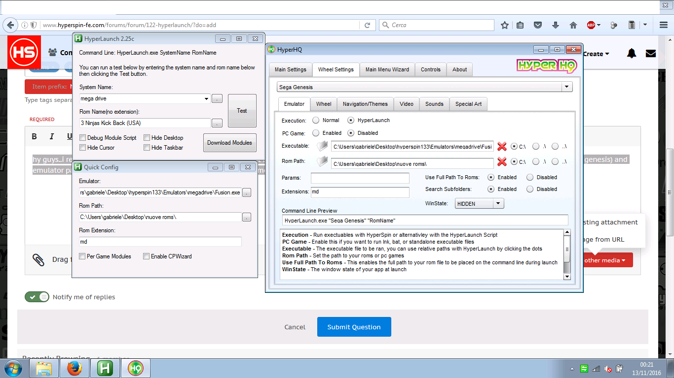

hy guys..i really love retrogames world and of course hyperspin,but i have a problem..when i use hyperlaunch.exe and i gonna set the rom extension (md for sega genesis) and emulator path..give me a wrong message when i try to select a game..."cannot find the rom ..with any provided extension" i'm gonna be creazy please help me!

Try this: in HyperLaunchHQ/RocketLauncherUI select the Sega Genesis/Mega Drive in the column on the left, go to System Settings, on the bottom of that, there is an option: Skip Check; try selecting "Rom Extension" or "Rom+Emu". (I think it was something like that, now i'm at work, and cant enter my RLUI)
Comment your result!
Regards!!!
