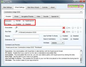

rfancella Posted April 11, 2014 Posted April 11, 2014 Hi, Please post your HyperSpin log. Read this post on how to do so: http://www.hyperspin-fe.com/forum/showthread.php?31072-The-HyperNoobie-Guide-For-Posting-To-The-Fourm Make sure your HyperHQ is set to use HyperLaunch like this: Thanks, Ron Code Monkey and all around Command Line geek!If you like what someone has said or done for you, be sure and 'Thank' them. And if they changed your life, send them a Beer!

rfancella Posted April 11, 2014 Posted April 11, 2014 Must i hook my arcade cab to the internet? I checked how to post a log, but why does it work with HL? Strange :) Could be that HyperHQ is not set to use HyperLaunch or HyperSpin is not using the correct HyperLaunch. Could be a number of things. No, you don't need to connect it to the internet. Try to launch the game through HyperSpin. Plug in a usb thumb drive and copy the log to it. Thanks, Ron Code Monkey and all around Command Line geek!If you like what someone has said or done for you, be sure and 'Thank' them. And if they changed your life, send them a Beer!
Abelientje Posted April 13, 2014 Author Posted April 13, 2014 Hello, i found the problem. Rfancella brougt me on a idea. The hyperlaunch CD32 wants to use was wrong. This is because my folder structure wasnt right. Maybe usefull to tell: I had Folder HyperSpin. Within that a Folder Hyperlaunch with Hyperlaunch. In there was a Folder called HyperLaunchHQ with of coz HyperlaunchHQ. Well al emulators so far took the "old" hyper launch in the HyperSpin folder. So i tought it was alright installed till Amiga Cd32....... What have i done: Ofcoz made a backup of Hyperspin so far (8 emulators with complete media etc etc) on a external harddrive. I merged the folders Hyperlaunch and HyperlaunchHQ in the Folder Hyperspin. By asking to merge or replace files....... yes! There are some tweaks about directories but by reading where hyperlaunch wants them i made Amiga CD32 working. (still need some buttons to onfg but that later) Okee for the other emulators i already had working... I have made changes for them too in HyperHQ and HyperLaunchHQ. So far got runing CD32, Future Pinball and NES. The others i gonna do ight now, 1st i would post this solution. I hope maybe some one ele find this usefull, thanks anyway!!! Kind Regards Abelientje
