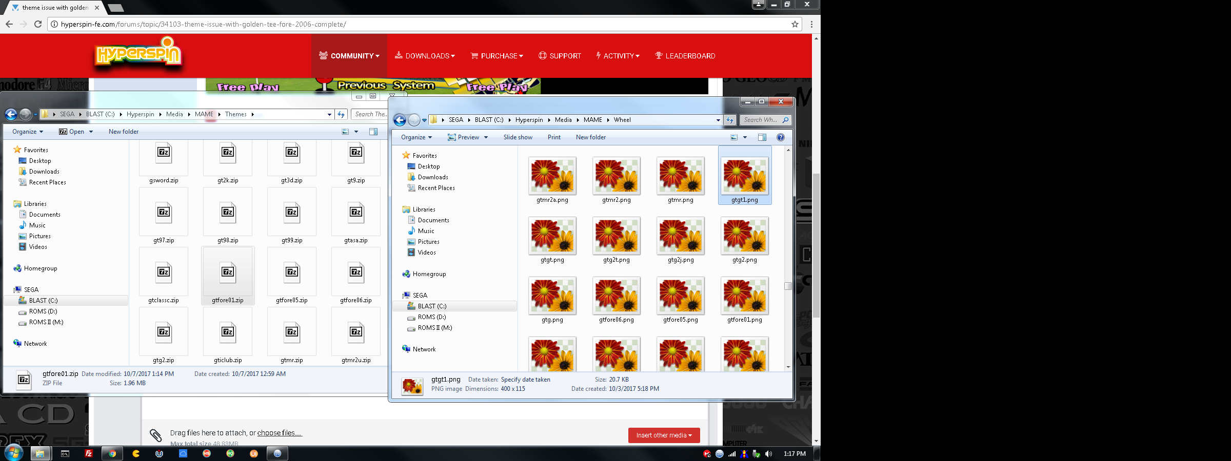

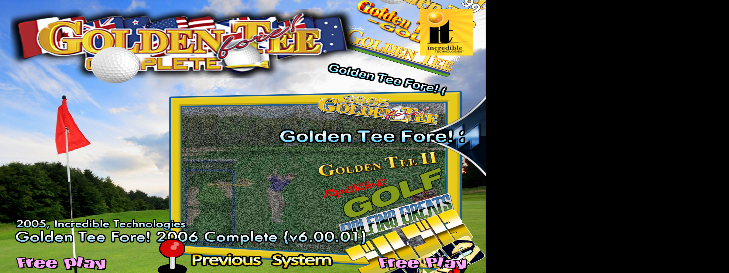

hey guys i just can't seem to get the wheel art for golden tee fore complete working can somebody help... i've uploaded a screenshot of what it looks like in my wheel. i've checked the media folder a thousand times and the theme and wheel .png is there... i'm lost... help....
Make sure the png is not PNG
Download the lastest mame.xml file from the site (0.189) - make a copy of your current one.
hey thanks for the reply.. the wheel art is there  and so is the theme. both are named correctly i've also grabbed the latest .xml and it still won't show  the wheel art for these games.. these are the only themes i've ever had trouble with.

I used a working png file, loaded it into gimp, deleted the image, added the logo for the game then saved it to the folder as gtfore06.png and it showed up fine.
It would appear that the two png files are corrupt in some way.
