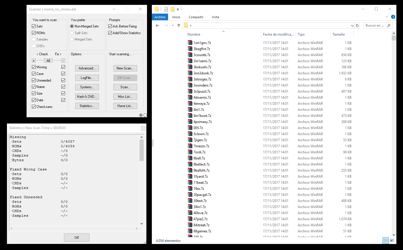

jfromeo Posted November 16, 2017 Author Posted November 16, 2017 Update I have downloaded current MAME 0.1901 xml pack from retroFE site, and loaded "mame_no_clones.xml" version into clrmamepro which contains 4057 roms (I assume most of them match the vid available ones at emumovies). I have performed a rebuilding and then a scan and got 0/4057 roms missing, but I have opened the destination folder and 90% of roms are 1kb in size. The 57GB pack has shrunk down to 0.99GB and the roms do not launch correctly either in MAME nor in HyperSpin. SO I guess the rebuilding process is not working as it should. Do I need to do anything to the xml prior to load it into clrmamepro? Maths say that I should be getting a ~20GB romset by rebuilding it with the 4057 roms xml (mame_no_clones.xml) after the packing them in 7z. Thanks in advance.
jfromeo Posted November 17, 2017 Author Posted November 17, 2017 This is where I am: No matter if I try with the split or unmerged MAME complete set, I am still getting a 0.99GB romset with lots of 1KB roms, despite getting 0/4057 misses in the Scan posterior to the rebuilding process. I am lost.
