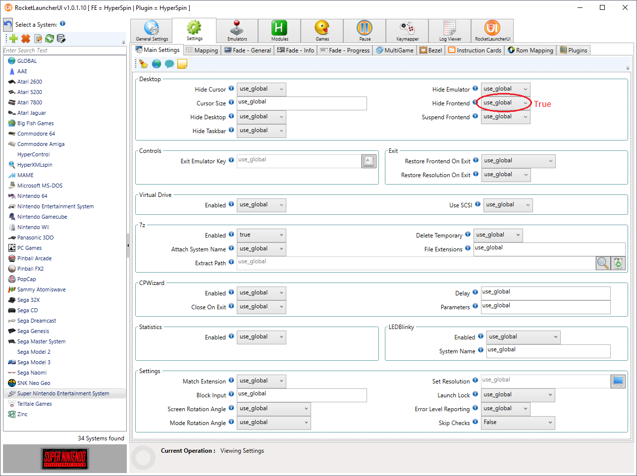

Bungles Posted November 25, 2017 Posted November 25, 2017 What are you using as a Launcher? Sounds like a problem with the settings where its not hiding the Front End. Retro Cafe - Universal ThemeHyperControl - Main Menu Config and Apps WheelAudiocade - Main Menu Music PlayerTelltale Games WheelPCGamers Top 100 PC Games 2014 WheelMGS HD Exit Screen8-Bitdo Special ArtAll Contributions My Youtube Channel - https://www.youtube.com/user/3ungle
Bungles Posted November 25, 2017 Posted November 25, 2017 I would start with this guy.. and then try some of the other settings. Also if your emulator is not set full-screen try fiddling with options in there. Worst case can try another emulator.. I use Retroarch for SNES and had pretty good success with it. Retro Cafe - Universal ThemeHyperControl - Main Menu Config and Apps WheelAudiocade - Main Menu Music PlayerTelltale Games WheelPCGamers Top 100 PC Games 2014 WheelMGS HD Exit Screen8-Bitdo Special ArtAll Contributions My Youtube Channel - https://www.youtube.com/user/3ungle
