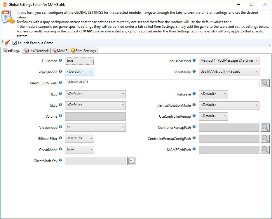

SupraKarma Posted December 13, 2017 Posted December 13, 2017 I'm not sure why when run from RLUI your ini settings aren't being respected. Agent's solution will certainly work, but I do not use that parameter on my setup and I do not have any issues. I also use MameUI64 though. Maybe it's a directory issue. I seem to recall MAME utilizing different directories for the ini depending on whether or not I ran a game directly from MAME, or from RocketLauncher. So, I have a couple of questions. 1. In your MAME module settings, in the MAME (or specific system) tab, do you have a IniPath specified? I do *not* on my end, but perhaps you could try that, and point it specifically to your MAME ini. 2. Have you checked to see if there are multiple sets of ini files being stored in different directories? I seem to recall being able to specify which set of ini's get used from MameUI64, using it's GUI. Here's screenshots of my MAME module settings for you. Again, my ini settings are respected (I've specifically tested the 'stretch' settings you described earlier), unless I mess with module settings. Hopefully this will help you figure something out. Main settings: MAME tab:

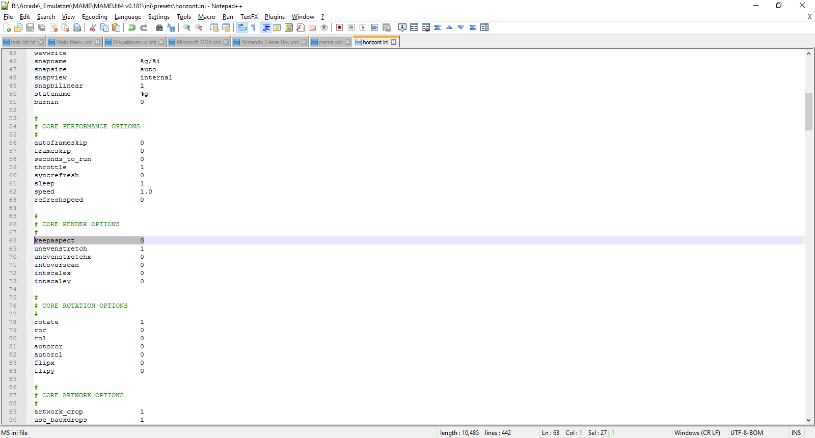

SupraKarma Posted December 13, 2017 Posted December 13, 2017 Just to be clear also, how are you achieving your stretched games in regular MAME? By altering the ini, or by using a setting in the GUI? I do it by altering the ini. The specific setting you need to change is Core Render Options/keepaspect 0 Screenshot: Note also that I use a file called horizont.ini, so that only horizontal games are affected. If you have not specifically created a file called horizont.ini, then the file you would need to alter will be called mame.ini
