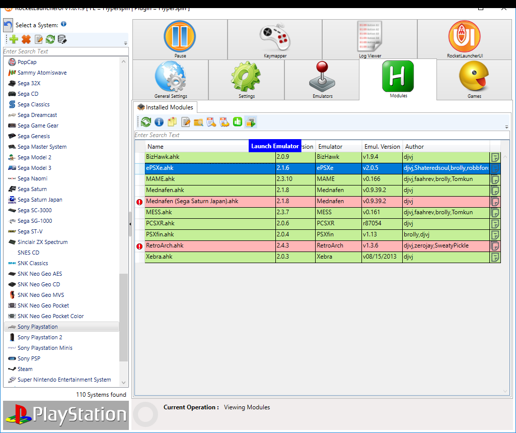

SupraKarma Posted December 15, 2017 Posted December 15, 2017 It'd be better to ask on the RocketLauncher forums, if you haven't already, as the devs might be able to pinpoint exactly what the problem is. The first thing I'd do is click on 'Sony Playsation' on the left tab, then click on your 'modules' tab, then highlight ePSXe, and click on the 'launch emulator' button. If it launches right up, then you indeed have the emulator path set up correctly. The fact that the emulator is not launching implies to me that it is not. But without more information, that's my best guess. Do you have ePSXe as a 'system only' emulator, or a global emulator?

SupraKarma Posted December 15, 2017 Posted December 15, 2017 No no, you're misunderstanding what I want you to do. Click on the following button.
sidlalami Posted December 17, 2017 Author Posted December 17, 2017 Thanks superKarma it worked I now have one issue. When iload the emulator and set the vidro plugin to petes d3d 1.77, it reverts to defsult when i launch the application via hyperspin/RL When I enter the module settings tab and select video plugin I can only see two options petes gpu opengl and epsxe gpu core version 2.0- the same applies if I click on the rom settings tag The only other option is to select <default > but this just tries to load petes OPENGL Is there a way to load the video plugin that I originally set up? Thanks so much
