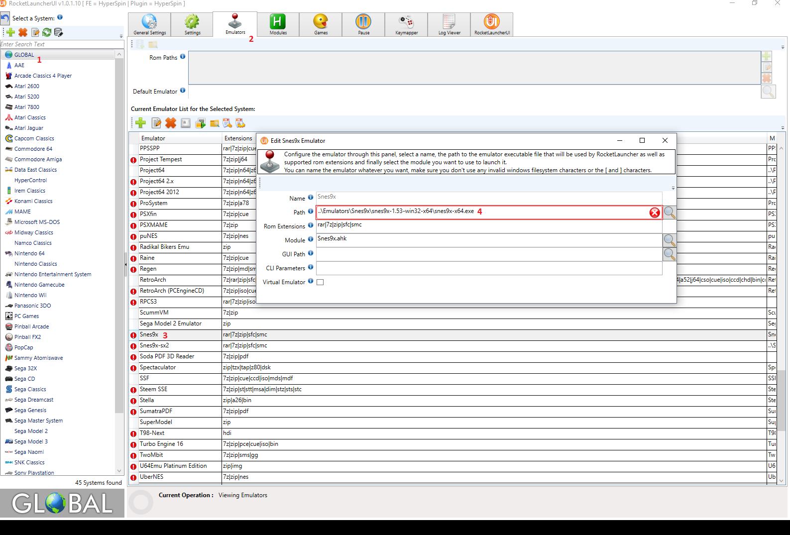

sidlalami Posted December 15, 2017 Posted December 15, 2017 Hi guys, Im having problems running snes9x through rocketlauncher/hyperlaunch. The emulator works fine if I open it via the application directly, however when I open it in RLUI I can locate the roms, the emu path is set correctly but when I launch a game I get the following Could not find your c:\Hyperspin Project- The frontend\Emulators\Snes9x\snes9x\snes9x-1.530win32-x64\snes9x-x64.exe Originally the folder where my emulator was was not what was mentioned in the string above, so I renamed the folders to match what it was looking for hoping it would work but to no avail Any suggestions please guys? Is there somewhere I can force the RLUI to look elsewhere, ive never even had a folder called snes9x-1.530win32-x64 ..... I am still a noob so any help is greatly appreciated Thanks
Bungles Posted December 15, 2017 Posted December 15, 2017 Should be in the Global emulator setup in RLUI. 1. Select Global. 2. Select Emulators. 3. Double Click on the Snes9x in the List. 4. Change your path. Retro Cafe - Universal ThemeHyperControl - Main Menu Config and Apps WheelAudiocade - Main Menu Music PlayerTelltale Games WheelPCGamers Top 100 PC Games 2014 WheelMGS HD Exit Screen8-Bitdo Special ArtAll Contributions My Youtube Channel - https://www.youtube.com/user/3ungle
