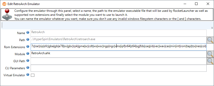

Bungles Posted January 30, 2018 Posted January 30, 2018 Check the extensions of your roms, are your new ones different from the rest? If they are archived is the extension inside for the new games different? If you are using Rocketlauncher you may need to add said extensions or your default emulators known extensions. You can copy the entire Rom Extension contents into a notepad and search for your extension. If not found add it/them in separated by a | of course. Retro Cafe - Universal ThemeHyperControl - Main Menu Config and Apps WheelAudiocade - Main Menu Music PlayerTelltale Games WheelPCGamers Top 100 PC Games 2014 WheelMGS HD Exit Screen8-Bitdo Special ArtAll Contributions My Youtube Channel - https://www.youtube.com/user/3ungle
