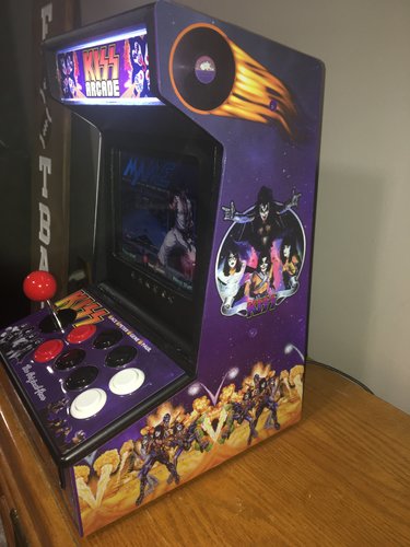

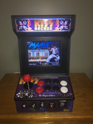

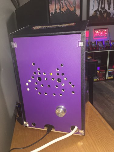

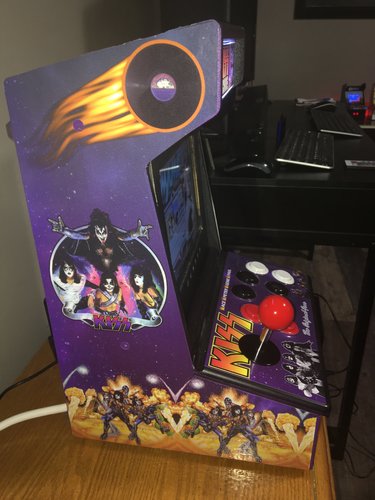

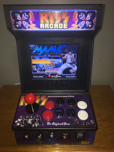

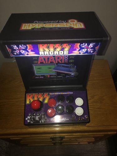

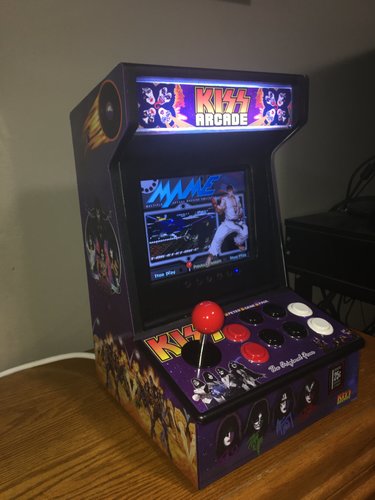

This is my ICade mod using USB encoder for the joystick and buttons with a Dell micro PC in the back end with USB volume knob. Powered by Windows 10, Hyper-Spin, and Rocket-Launcher with Atari 2600, MAME, Nintendo Entertainment System, and Sega Genesis emulators and roms set up. The display is a 4:3 8 inch Neewar monitor which I purchased off of Amazon. I have acrylic glass behind my wooden bezel which I drilled out holes for monitor buttons in both the bezel and glass. All artwork was created by me in Photoshop and printed on adhesive vinyl. The marquee was made with the same acrylic glass and has an 8 inch LED glass enclosure with remote made for small fish aquariums I purchased off of Amazon as well. All wood paneling is MDF material and was cut and drilled via a Black and Decker drill with spade bits and a small Dremel band saw. I mostly used gorilla glue to piece everything together. I used Behr Marquee 2 in 1 primer and paint to paint the MDF material. The Hyper-Spin intro video was created by me using open source and free program Open Shot Video Editing. It took me roughly 2 months to complete from start to finish in between work and my family lol. I am so glad I did it though I am so pleased and happy with the outcome. A match made in Heaven! MY favorite band KISS (original members) and my favorite hobby retro arcade. I absolutely love it!
