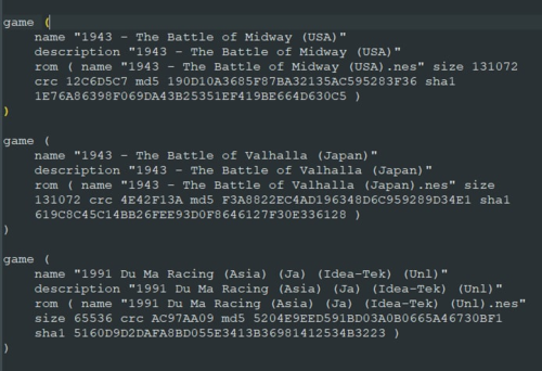

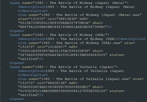

Making look this:
Into this:
I had to delete the first and last tag <datafile> but I think that's pretty obvious.
Now the .dat file can be used by Dons HyperSpin ROM Renamer.exe and probably other programs.
