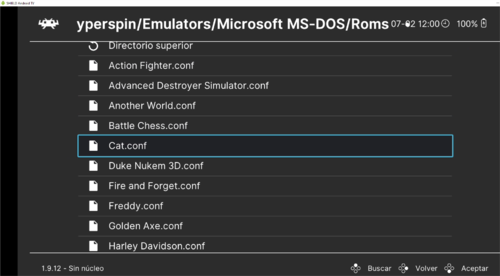

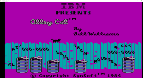

Before describe the error, I want to show you that the games and emulators are working fine if I manually load them in RetroArchPlus. Here is the Alley Cat example:

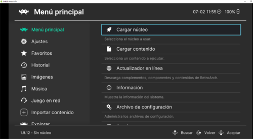

- If the RetroArchPlus application is not running (because I've close it) then some really strange things happen:
(the above image shows what happen after I select the game from hyperspin, having the RetroArchPlus previously closed)

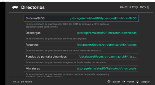

It launches the RetroArchPlus (same app, same version...) but the things are rare (different text styles, nothing configured...). For example there are errors saying that the directories are not set, and that's true, if I check this config is all empty!
I promise you I had this config filled in my app. Well, I can show it you because if I close the app and open it again, the "things" are restored again:

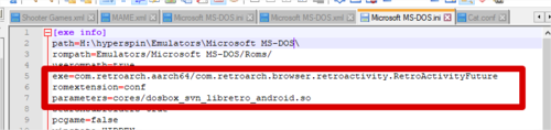

The ini file sounds like that:
It's supposed to be fine, but something is not in some place. I have noticed all the other emulators that uses RetroArchPlus have the same issue (when launched from hyperspin).
