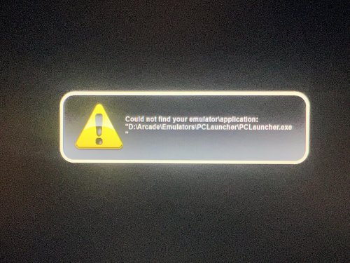

Udirlei Justino Posted July 15, 2023 Posted July 15, 2023 Hello friends, all right, can you help me with my Hyperspin system that is appearing this message when I try to open some games in some emulators, I've tried everything and I can't because I'm a layman in the subject and I understand very little and watching research I decided to resort to forum and I decided to ask you for help these are the PC games: Unable to find your emulator application: “D: Arcade:Emulators/PCLauncher/PCLauncher.exe I looked for this folder and files in the emulators folder and I didn't find it, if it's supposed to be in the emulators folder then it isn't, I already looked in other folders to see if it was suddenly transferred by accident but I didn't find it, worse than it is in the best emulators that this one is appearing message and there are several emulators such as TAITO TIPEX, TAITO TIPEX2, PC, TECNO PARROT among others, thank you in advance for everyone's help and attention!

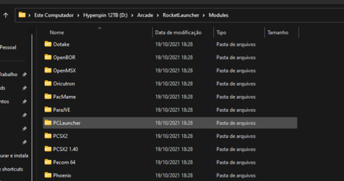

Andyman Posted July 15, 2023 Posted July 15, 2023 I'm guessing you are using RocketLauncher. If that is true, PCLauncher is in the Modules folder in RocketLauncher, and you will need to configure your setup to point to it there. You will also need to configure each PC game in PCLauncher.ini as well (or any other app you are using PCLauncher with). There are examples in the .ini folder you can copy and modify to use.

Udirlei Justino Posted July 16, 2023 Author Posted July 16, 2023 5 hours ago, Andyman said: Eu estou supondo que você está usando o RocketLauncher. Se isso for verdade, o PCLauncher está na pasta Modules no RocketLauncher e você precisará configurar sua configuração para apontar para ele lá. Você também precisará configurar cada jogo para PC no PCLauncher.ini (ou qualquer outro aplicativo com o qual esteja usando o PCLauncher). Existem exemplos na pasta .ini que você pode copiar e modificar para usar. Andyman achei essa pasta e o que fazer agora?

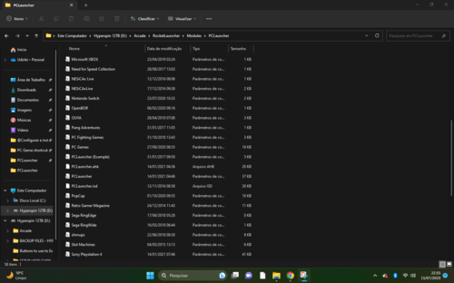

Udirlei Justino Posted July 16, 2023 Author Posted July 16, 2023 1 minute ago, Udirlei Justino said: Andyman achou essa pasta e o que fazer agora? essa pasta ini nao localizei

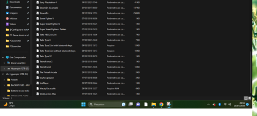

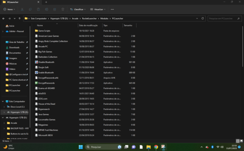

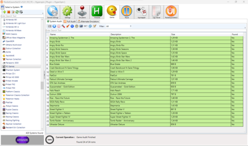

Udirlei Justino Posted July 16, 2023 Author Posted July 16, 2023 Just now, Udirlei Justino said: essa parte de configuracao do que preciso me deixa muito confuso pois nao sei fazer as configuracoes, pode ser se ver alguem fazendo em um video pode ser que consiga fazer algo 4 minutes ago, Udirlei Justino said: essa parte de configuracao do que preciso me deixa muito confuso pois nao sei fazer as configuracoes, pode ser se ver alguem fazendo em um video pode ser que consiga fazer algo 7 minutes ago, Udirlei Justino said: essa pasta ini nao localizei, e esses prints que enviei é o conteudo da pasta pclauncher 4 minutes ago, Udirlei Justino said: essa parte de configuracao do que preciso me deixa muito confuso pois nao sei fazer as configuracoes, pode ser se ver alguem fazendo em um video pode ser que consiga fazer algo 4 minutes ago, Udirlei Justino said: essa parte de configuracao do que preciso me deixa muito confuso pois nao sei fazer as configuracoes, pode ser se ver alguem fazendo em um video pode ser que consiga fazer algo 5 hours ago, Andyman said: Eu estou supondo que você está usando o RocketLauncher. Se isso for verdade, o PCLauncher está na pasta Modules no RocketLauncher e você precisará configurar sua configuração para apontar para ele lá. Você também precisará configurar cada jogo para PC no PCLauncher.ini (ou qualquer outro aplicativo com o qual esteja usando o PCLauncher). Existem exemplos na pasta .ini que você pode copiar e modificar para usar. 5 minutes ago, Udirlei Justino said: essa massa ini nao localizei 3 minutes ago, Udirlei Justino said: essa parte de configuracao do que preciso me deixa muito confuso pois nao sei fazer as configuracoes, pode ser se ver alguem fazendo em um video pode ser que consiga fazer algo
