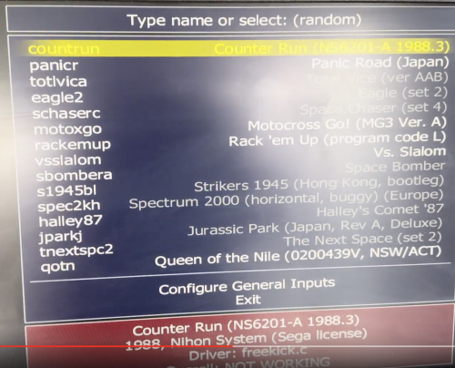

sandyring Posted November 7, 2023 Posted November 7, 2023 Hi there, I don't exactly know what to search for with regards to this, I've looked at various hyperspin guides but not seen this come up in any of them - i've provided a video of what happens when I try to start a game, any info even what it's called would help would my further investigations....I am referring to the blue screen with white writing which comes up as per the video... https://drive.google.com/file/d/1EsDe9cNs4q4W7R4BzGGdee_idTfNbbxb/view?usp=sharing I thank you so much in advance for any help!.

sandyring Posted November 8, 2023 Author Posted November 8, 2023 to make it even more clearer this is the screen I am seeing and confused about:....
jesfknkrys Posted November 8, 2023 Posted November 8, 2023 2 hours ago, sandyring said: to make it even more clearer this is the screen I am seeing and confused about:.... Does MAME run properly without Hyperspin? I use the attached Rocket Launcher Module for the most recent version of MAME, hopefully that helps. MAME.ahk
sandyring Posted November 13, 2023 Author Posted November 13, 2023 Ok so finally i've had some time to come back to this, what seems to be happening even outside of hyperspin and trying to start Mame by itself directly is that I get the 'menu' if you like, so I have figured out this menu is related to Mame - what I don't quite know if how you can configure hyperspin to start a chose game using mame and not have this menu appear...

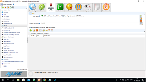

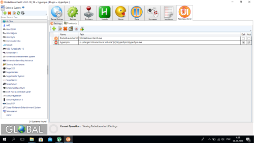

sandyring Posted November 13, 2023 Author Posted November 13, 2023 ok so i think i have it figured out for anyone stumbling across this in the future, the fix appears to be as per picture the yellow flagged items have to be as shown:
