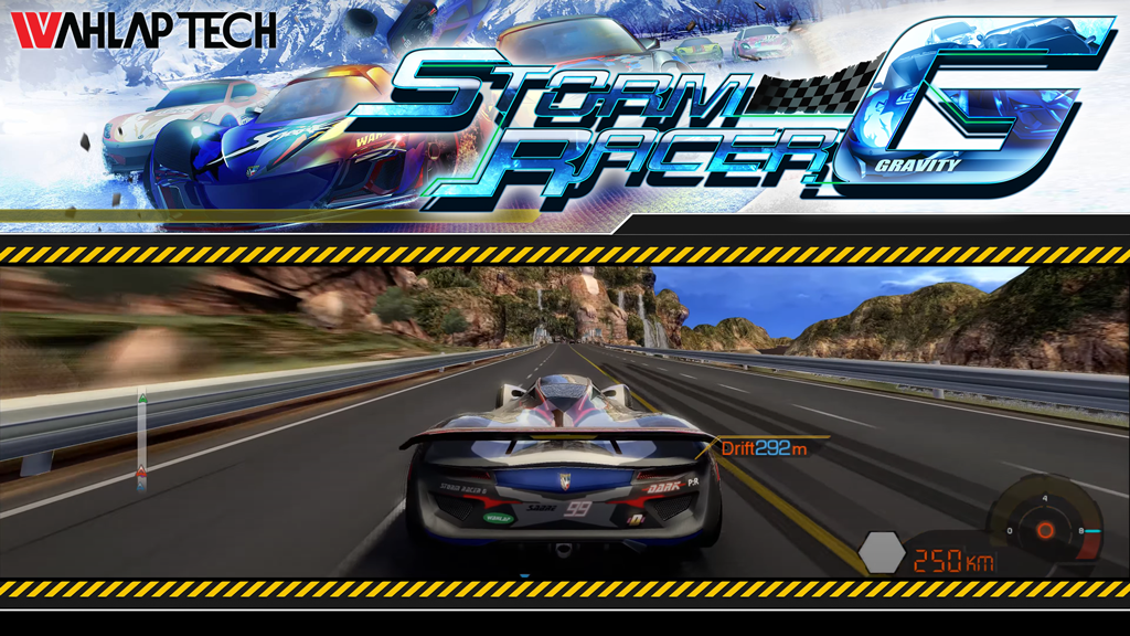

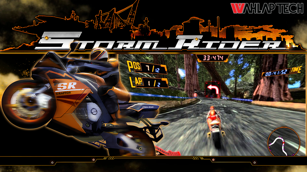

Here are the first two ArcadePC themes that I did: Storm Racer G (SRG) and Storm Rider (StormRider). For Storm Rider, I used a lot of screen captures for the bikes and details. Then I upscaled them with an online tool (https://www.iloveimg.com/) and cleaned up any details in Photoshop. For clean edges on cut out artwork, I use the pen tool to create vector masks.
Side note: I am not a fast theme builder like some of the greats from the past, but I do strive to make high-quality themes every time.

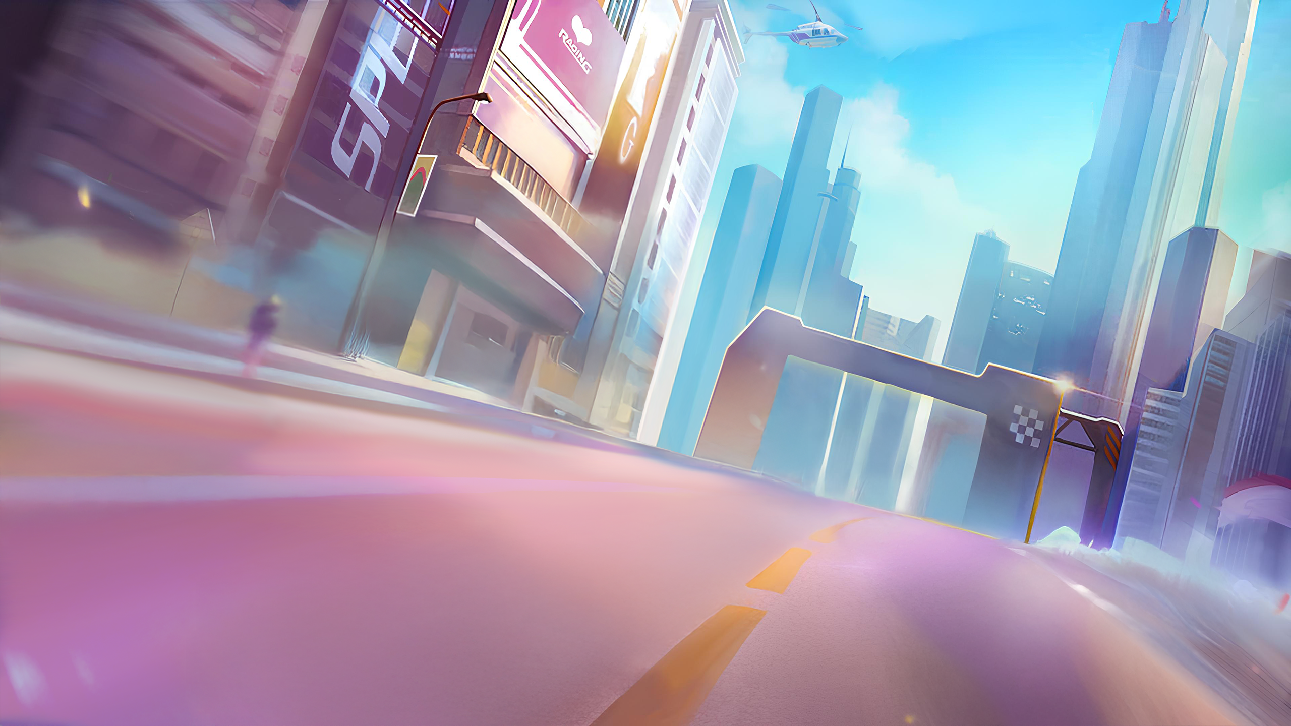

Next up is Crazy Ride by UNIS. This one had a nice wallpaper/background readily available, but I needed to cut out the cars to animate it.
I used Photoshop's "generative fill" as the first step to replace the gaps. I had to try multiple variations to get close to the desired outcome, and then I cut and pasted several sections together. It's not perfect, but if you don't study it too much, it looks pretty good.
I wanted the yellow car to move in from off screen and hover, so I had to rebuild the front corner that was cut off in the wallpaper. Generative fill got me the approximate shape that I wanted (again, it took several variations). Then I copied and pasted the headlights and fog lights to finish it off.
I got the best title that I could find, upsized it, and cut it out cleanly with the pen tool. Then I zoomed in and made additional touchups by hand. To make it a more dynamic and integral part of the theme, I changed the perspective too.
