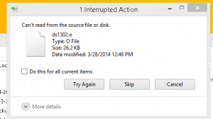

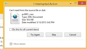

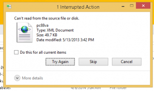

bearzilla333 Posted August 21, 2014 Author Posted August 21, 2014 ok it says "Can't read from the source file or disk" does to XML files and other files such as H or C files as well. My first project: http://www.hyperspin-fe.com/forum/showthread.php?33389-MY-first-Cabinet-Overkill
Guest Posted August 21, 2014 Posted August 21, 2014 Can you show more details on that? Also try copying that individual file across. Sent from my iPhone using Tapatalk
bearzilla333 Posted August 21, 2014 Author Posted August 21, 2014 other 2 I just did some snippets, I noticed some of the files under emulation/source... My first project: http://www.hyperspin-fe.com/forum/showthread.php?33389-MY-first-Cabinet-Overkill
Guest Posted August 21, 2014 Posted August 21, 2014 It's seems that your having problems copying across the source files of the emulators. You don't really need them. They could have odd file names. Sent from my iPhone using Tapatalk
